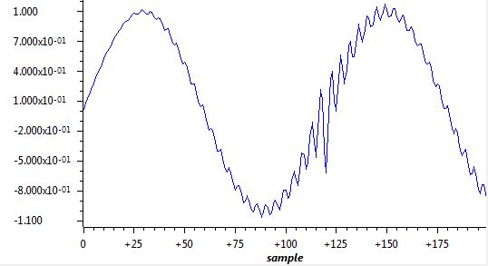

I have tried to implement the basic example presented in the document in CCS v5.5.
Here I have used DSP library to implement FIR Filtering (DSPF_sp_fir_gen).
When I compare my results from the documentation, my results are marginally different.
I tried many cases but still unable to get the results in the documentation.
Here the code.

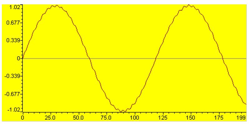

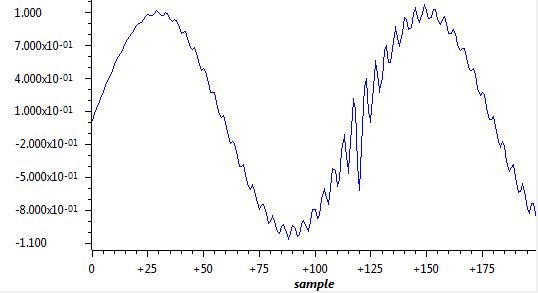

RESULTS
Result from Document
My code result.
One can clearly observe that the results are different and F2 is not completely filtered from the input signal in my case.
Can anyone please help me with the solution or an answer.
please guide me if there is an error in coding.
