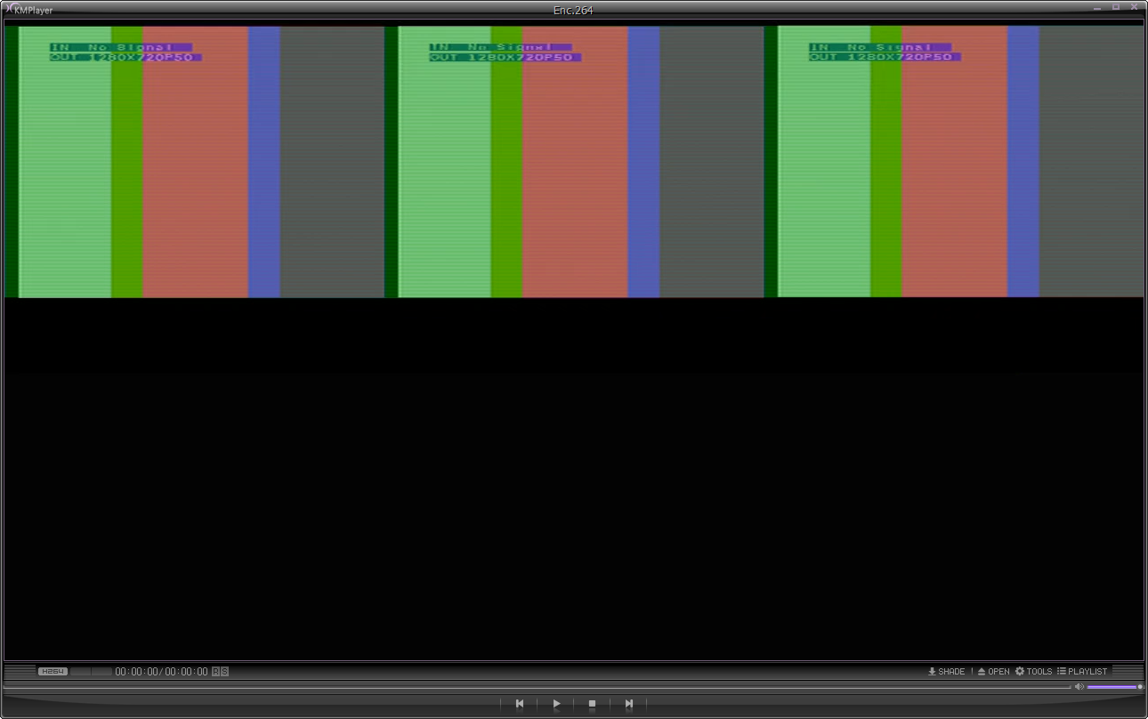

Meanwhile, in most cases, I could get nothing in my output H264 file. Yet, I could occasionally get a encoded H264 file with only one I-frame exist, although it is not likely a correct output:
And my questions is:
Why the M3VPSS cast OVERFLOW issues? How can I change the VIN0 PORTA capture mode into 16bit embedded sync?
