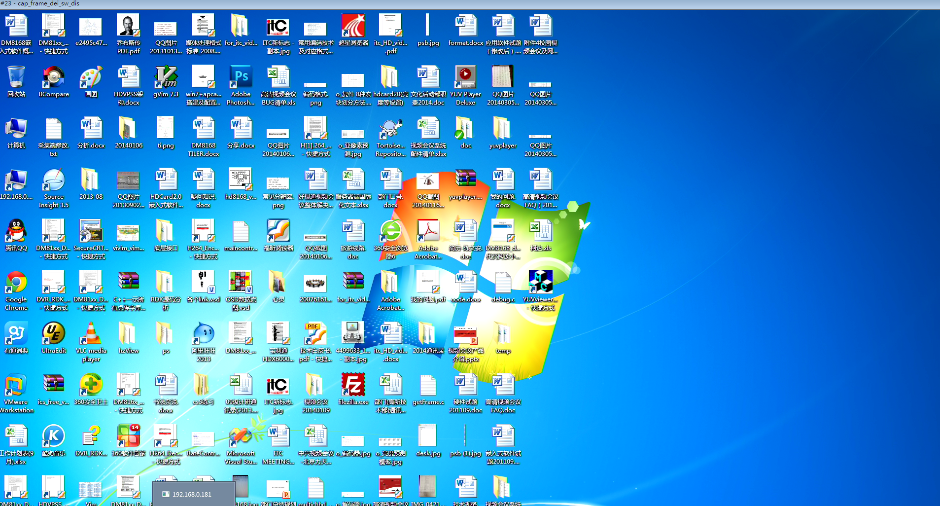

    I want to dynamically change the encode resolution, so I use DEI link before ENC LINK. However ,the quality of image so bad. for example ,
    there are two chains : (1) cap-sw-dis    (2) cap-dei-sw-dis
    it so easy to find: The quality of image after CAP link is better than the one after DEI link.
