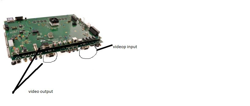

  • Hi Margarita,
    It would be better to point me which demos you are trying to execute or what you are trying to archive (decode-display, capture?).
    --->>>we want to do just loop back of video capture,what we get in camera,simply it has to  display on TV.is there standard demos for this type of program. in the given SD CARD ,if so please tell me the path and name the demo,requesting to tell the procedure how to get the output.we did "make all",and what to do next to run this demo only.because after seeing the pdf ,we are in confusion about the procedure.
    Another thing is we got a kit which comes with daughter card,in daughter card i think we need to connect the camera,as i dont find any input on the board itself to give input but i found output on the board.if so what kind of camera is suitable for doing this.
    thank you.

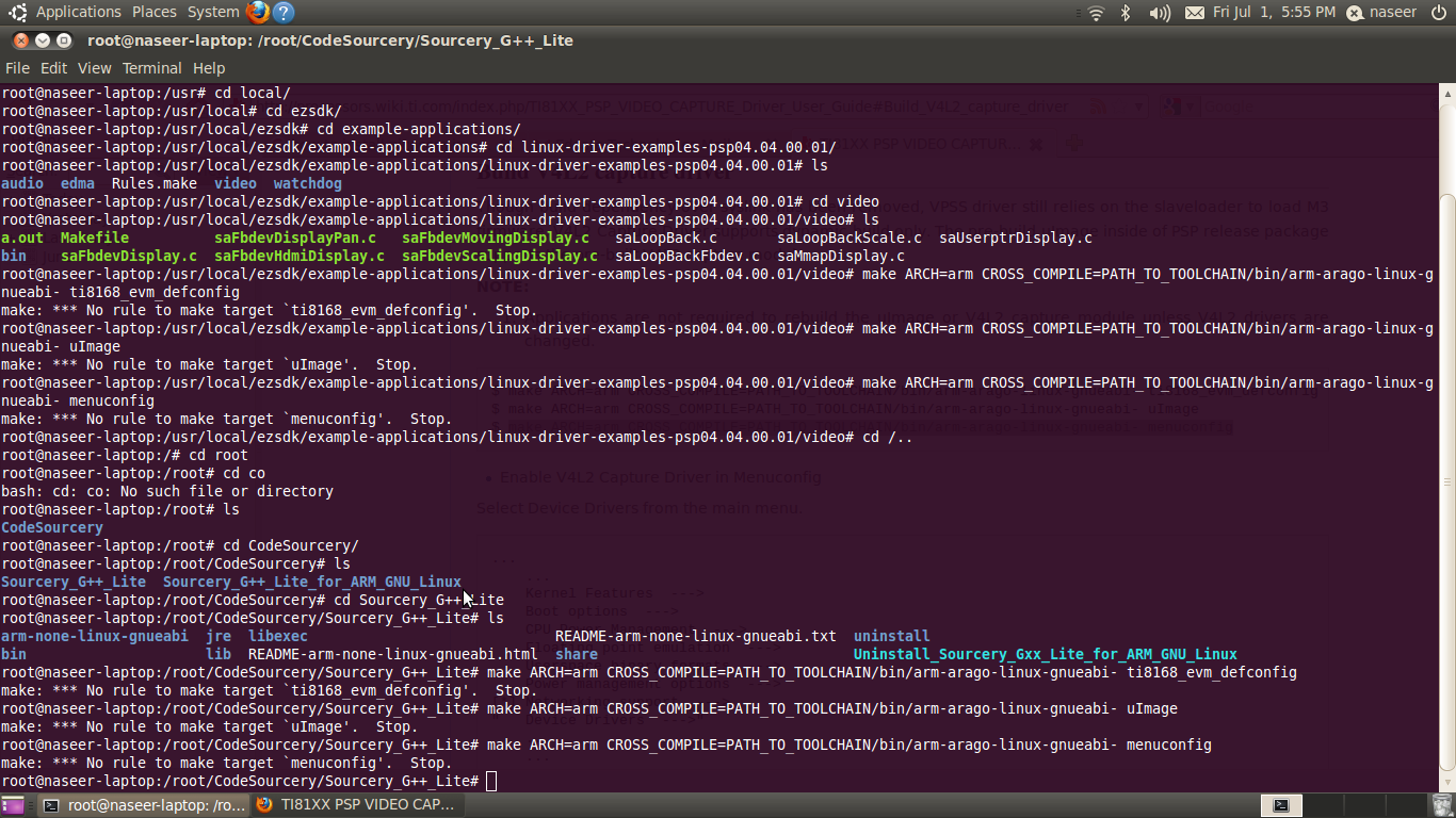

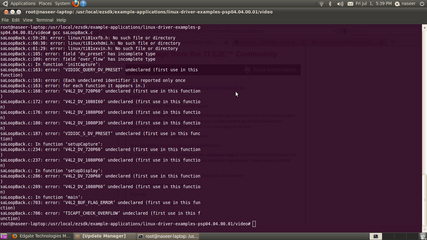

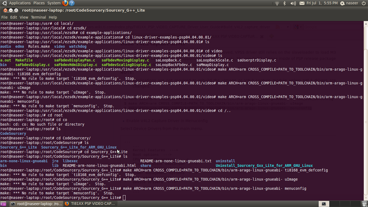

  • Hi Margarita,
    I did gcc of  saLoopBack ,i did that error...and v4l2 capture  display driver i got error shown in attachment
    please sort it out.
    thank you

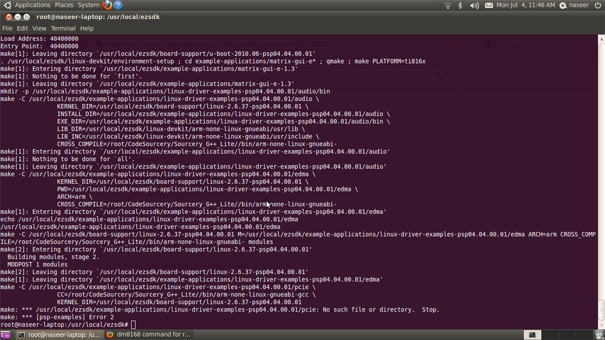

  • Hi Margarita,
    U did Make all,but at the end i got" 2 errors in making",then i did gcc to that video loopaback example,"gcc example.c...i got same errors wat i posted attachment in early conversation...
    why this is happening,how to over come with this...
    thank you.
    What errors you are seeing with make all command?
    Are you using the default ezsdk?
    BR
    Margarita
  • Hi Margarita,
    --->>>please see the attachment "sreenshot".
    --->>>yes.
    After doing "make all",i got error,but still i did CD and in VIDEO path,i did "GCC saFlopback.c",i got error...please see the "screenshot1".
    I only installed EZ by installing codesourcery,nothing apart from this.
    thank you
    In the EZSDK for dm8168 we have ti-ezsdk_dm816x-evm_5_05_02_00/example-applications/linux-driver-examples-psp04.04.00.01/pcie folder(which contains pcie example demo) could you check are you have it ?
    1.I have attach this folder (8272.pcie.tar.gz) extract it  here /linux-driver-examples-psp04.04.00.01
    2. or you could remove it from the makefile in the EZSDk install folder.
        $(MAKE) -C $(PSP_EXAMPLES_INSTALL_DIR)/pcie \
            CC=$(CSTOOL_PREFIX)gcc \
            KERNEL_DIR=$(LINUXKERNEL_INSTALL_DIR)
    After some of this steps try again make all command.
    BR
    Margarita
    which is the component input in the board...?
    thank you.

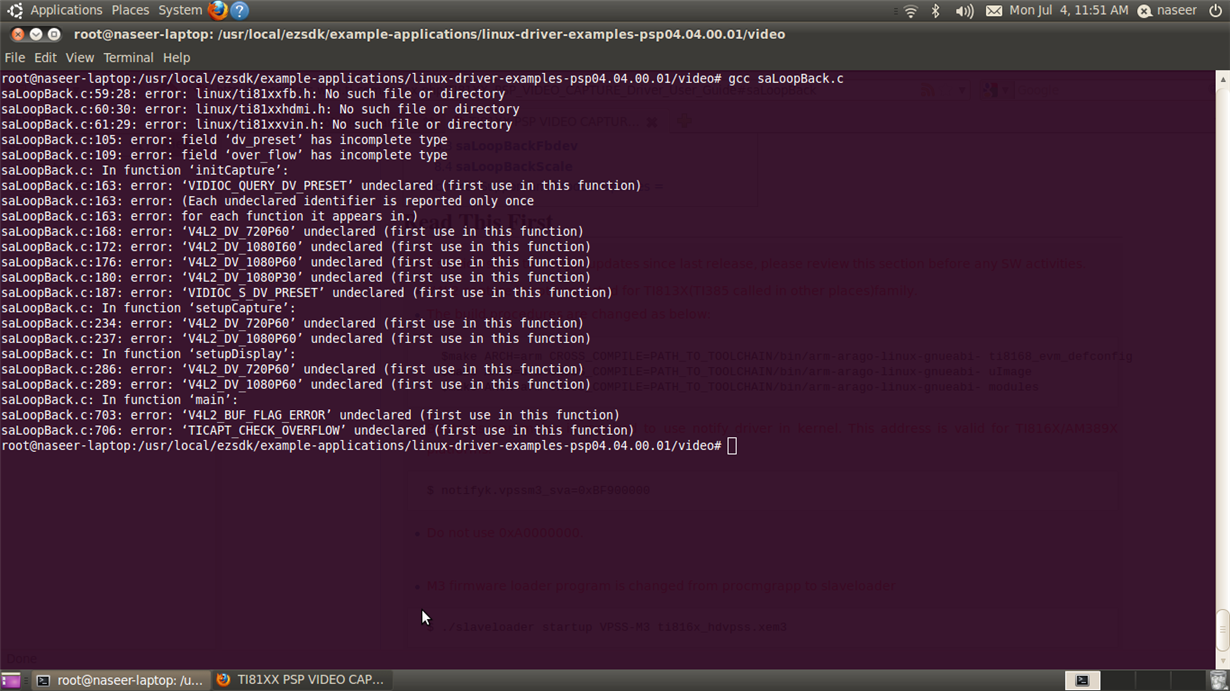

    I overcame the errors of "make all",but if i do "gcc saLoopback.c",i got the errors.the same
    e2e.ti.com/.../Screenshot_2D00_1.png,what to do with this.
    thank you.
    Are you able to allocate in ezsdk/example-applications/linux-driver-examples-psp04.04.00.01/video/bin  folder build saLoopBack demo with make all command?
    Capture source must be connected to the component input of IO EXPANSION board(J5,J6,J7).
    BR
    Margarita
