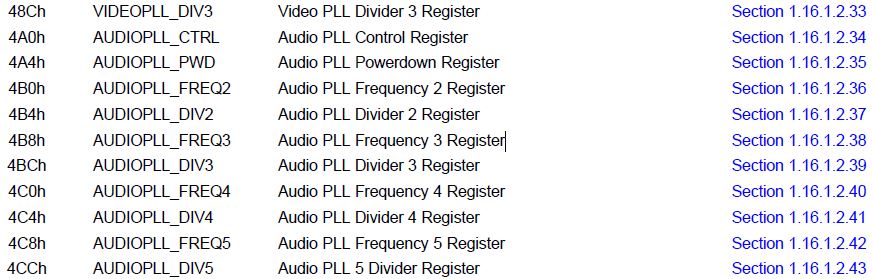

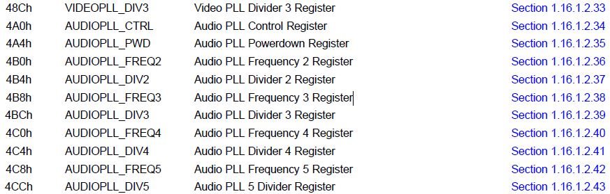

    1. Customer has checked the sysclk18 and it can from 32Khz or Audio PLL clock 1. But there is no register which can configure Audio PLL clock 1.
    2. Customer has tried to change sysclk6, but no effect.
    Customer has made own board which uses WD_OUT to trigger the external circuit to reset the whole system, but due to removing the jitter for bottom, they add a capacity which affects WD_OUT signal due to short period pulse. So they want to increase the high period of the WD_OUT pulse.
    Would you pls help to check again if there is any way to increase the WD_OUT pulse?

    There is no register for Audio PLL clock 1. No AudioPLL_FREQ1/AUDIOPLL_DIV1.
  • Chris,
    Correct. Seems that Audio PLL clock 1 (sysclk18) is fixed at 32KHz and can not be changed.
