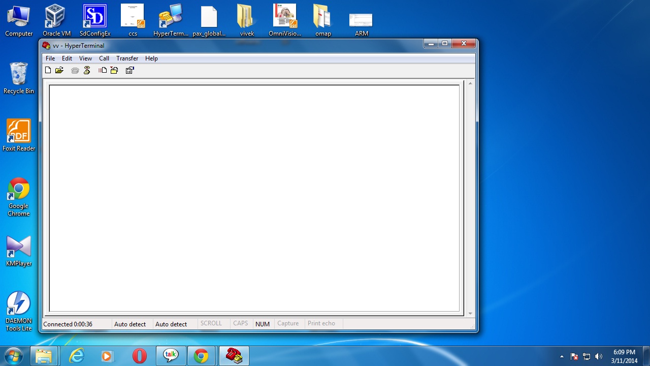

  • sir
    when we connect it with the hyperterminal after selecting the com port and boudrate it shows connected but it does't boot after resetting the kit it does not shows any message the switch settins are 1off 2,3,4 on and  others are off
    what happened i can't understand what should be done get it back?

  • sir,
    yes sir i configured the sw1 accordingly as above for NAND 16 .Earlier it was booting the kernel now it is not i have once inserted the card in ubuntu  but i did't did anything i just seen the files after re flashing NAND these problem came.
     i am not getting way .what should be done ?? now
  • yes sir i configured the sw1 accordingly as above for NAND 16 .Earlier it was booting the kernel now it is not i have once inserted the card in ubuntu  but i did't did anything i just seen the files after re flashing NAND these problem came.
    Ahhh you are confusing now you mentioned earlier you want to get it booted from SD boot mode then why are you setting the switch to NAND boot mode ?
    --Prabhakar Lad
  • Sir earlier it was booting the kernel on teminal when sw1 switch is on NAND mode means 1off 2,3,4 on sir what problem occured i am not getting...
  • Also it is not booting on SD boot mode when setting pins to SD boot mode??
    By any chance did the SD card get corrupted? is it getting detected on other machine ? What I can suggest is use a different SD card and reflash the uboot, kernel & filesystem on it using this link http://processors.wiki.ti.com/index.php/OMAP-L138_Preparing_SD_Card_for_Boot
