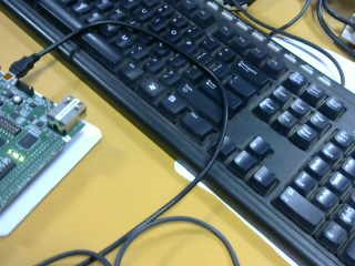

  • ok now i can take images through USB cam i fowwowed below
    root@vivek-HP-Pavilion-g4-Notebook-PC:/media/vivek/rootfs# tar -zxvf /home/vivek/Desktop/omap/5428.patch_uvccapture.tar.gz
    bin/
    bin/uvccapture
    lib/
    lib/libjpeg.so
    lib/libjpeg.so.62
    root@vivek-HP-Pavilion-g4-Notebook-PC:/media/vivek/rootfs# umount /media/vivek/START_HERE/
    root@vivek-HP-Pavilion-g4-Notebook-PC:/media/vivek/rootfs# umount /media/vivek/boot/root@vivek-HP-Pavilion-g4-Notebook-PC:/media/vivek/rootfs#
    root@vivek-HP-Pavilion-g4-Notebook-PC:/media/vivek/rootfs# cd /
    root@vivek-HP-Pavilion-g4-Notebook-PC:/# umount /media/vivek/rootfs/
    root@vivek-HP-Pavilion-g4-Notebook-PC:/# sync
    booted the card i did the following
    Arago Project http://arago-project.org omapl138-lcdk ttyS2
    Arago 2011.09 omapl138-lcdk ttyS2
    omapl138-lcdk login: root
    root@omapl138-lcdk:~# usb 1-1: new full speed USB device number 2 using ohci
    usb 1-1: New USB device found, idVendor=046d, idProduct=0825
    usb 1-1: New USB device strings: Mfr=0, Product=0, SerialNumber=2
    usb 1-1: SerialNumber: E6B6FD60
    uvcvideo: Found UVC 1.00 device <unnamed> (046d:0825)
    input: UVC Camera (046d:0825) as /devices/platform/ohci.0/usb1/1-1/1-1:1.0/input/input0
    root@omapl138-lcdk:~# ls
    root@omapl138-lcdk:~# uvccapture
    inserted the card on host machine
    Got the image as in rootfs/home/root snap.jpg through web cam which is
    now how to stream it through VGA port display?

    i can see the video through vga port
      Thank u for support
