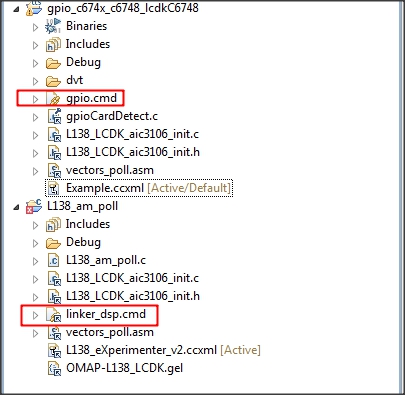

I'm working with my TMS320C6748 in a functional gpio project. Now I want to include the audio codec in my project (L138_am_poll), but I have some problems on it.
Theoretically, I just have to add the library "L138_LCDK_aic3106_init.h" and the "L138_LCDK_aic3106_init.c" to my project. And then update the compiler and linker included files.
But, what should I do with the cmd file of each project?

    I've tried to join both cmd files but I couldn't make it. Could help me with this? These are the cmd files:
    gpio.cmd

    linker_dsp.cmd  (audio codec)

    I also have problems with the obj files, but first I think we should join the cmd files. All the errors I get on the building process are involved with L138_LCDK_aic3106init.obj

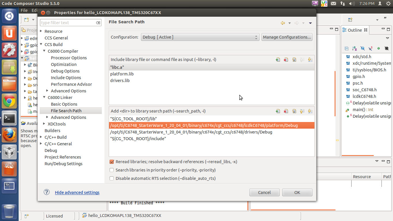

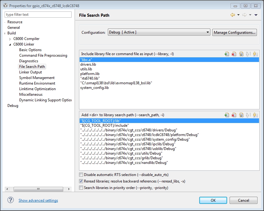

    This error seems linking error,
    What are your projects trying to combine?
    I have doubt on your project linking.
    Provide your exact libraries name in linking options (ex: drivers.lib, platform.lib)
    Share your screen shot of  linker options from CCS "properties"
    This is the screen shot of my linker file search path:
    Miguel.
    Attachment is not available,
    I think it is missed.
    Please check it and attach the same.
  • Sorry. Linker - file search path:
    Miguel.
    Try to give the exact location path of libraries than using "../../"

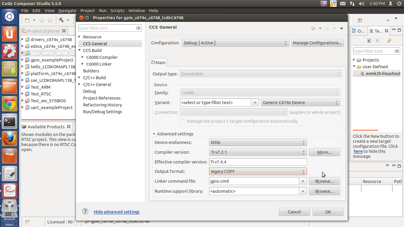

  • Hi Miguel,
    I'm able to build your project which is combined gpio and audio projects.
    The following issues were identified in your project build.
    1) "evmomapl138_bsl.lib" libraries were compiled in "COFF" format, So you are getting linker error when you trying to build with combined GPIO & audio project with "ELF" format.
    2) We can't build "evmomapl138_bsl.lib" library in ELF format since we don't have source code of that instead we need to compile the our combined format in "COFF" format.
    3) We have to compile the "drivers.lib" and "platform.lib" libraries in COFF format also, since those libraries were compiled in ELF format already.
    I'm not sure about the functionality because "audio" project is from "EVM" board and "gpio" project is from "LCDK"
    I will send your modified project through email.

    I received the above shaded error for "drivers.lib" and "platform.lib" which is required to build "gpio" project but the above "system_config.lib" is not required for your project, that why we didn't receive any error.
  • How did you change the format of the libraries?
    Sorry for the delayed response.
    Select your project and click "properties" option and choose "COFF" in "Output format" settings.
  • Ok! It worked for me! I just had to choose the COFF format!
