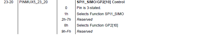

    i need to use a GPIO pin which conflict with SPI1 since its used by RBL while communicating with 64Mb Bootflash

  • After the ROM Bootloader has transfered code from SPI Flash to RAM, you can change the function of the pin from SP1_SIMO to GP2[10]. I assume GP2[10] is connected to some device. You must ensure that the SPI flash and device are selected. That means that SP1_SCS0 must be retained. It will deselect the SPI Flash while you using the pin as GP2[0]. Simlarly your device must not look at the pin when SPI Flash is selected.

    i assume from your above explanation  that we should configure the pin as GP2[10] so that after using as SPI1_SIMO during booting,this pin will be used as GPIO for my application.i have configured PINMUX5  as 0x00800000 which means that its selects GP2[10] .i have added this PINMUX  value both in my program and  AISgen while creating the .bin file but my application does not run in SPI flash mode with this addition.when i remove this PINMUX5 value from my AISGen,the application runs smoothly in flash mode.i dont know why this is happening and why i am unable to give this value.

  • Not sure I understand. When you say configure the pinmux, I assume you are doing this in AISGEN. I have been a while since I used AISGEN. All the settings a applied before data transfer. So the pinmux must have configured for SPI1 in AISGEN. As far as I know, AISGEN does not have post transfer settings that would allow remuxing of the pins. Usually your application code would manually change the pinmux before using your device. Check your code to see if there is pinmux library. Probably that some other code is already modifying the pinmux. Remember that your device will see the SIMO signal during boot and must be deselected during this time.
  • Hi Norman,
    You were right.AISGEN does not have post transfer settings that would allow remuxing of the pins.i removed the pinmux value from AISGen and retained in application code and hence application works smoothly and now i can use it as GPIO.
