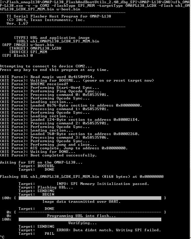

I can't copy ubl into flash SPI with FlashAndBootUtils_2.40 tool; I get this msg :
The erase seems working good.
I changed structure hDEVICE_SPI_config with different manner.
Is it possible my flash is incompatible?
Do you know how to configure it.

  • No, about spi flash, I've just modified device_spi.c on stucture DEVICE_SPI_params (not DEVICE_SPI_config : sorry I made an errror) like this :
    const SPI_MEM_ParamsObj DEVICE_SPI_MEM_params =
      SPI_MEM_TYPE_FLASH,
      24,                     // addrWidth
      256,                    // pageSize
      #ifdef AM1810
      4096,                   // sectorSize
      #else
      0,                   // sectorSize
      #endif
      64*1024,                // blockSize
      4*1024*1024 /*8*1024*1024 */            // memorySize

    In fact, I receive 0xFF (from SPIBUF register) after each writing byte (to SPIDAT1 register) to flash.
    But I don't know why?
    See :
    Uint32 SPI_xferBytes(SPI_InfoHandle hSPIInfo, Uint32 numBytes, Uint8 *spiBuf )
      VUint32 *spiTxReg;
      Uint32  i;
      DEVICE_SPIRegs *SPI = (DEVICE_SPIRegs *) hSPIInfo->regs;
      spiTxReg = &(SPI->SPIDAT[DEVICE_SPI_DATOFFSET]);
      // Clear any overrun conditions
      if (SPI->SPIFLG & SPI_SPIFLG_OVRNINTFLG)
        spiBuf[0] = (SPI->SPIBUF);
        SPI->SPIFLG &= SPI_SPIFLG_OVRNINTFLG;
      // Write output data
      for (i=0; i< numBytes; i++)
        // Wait for transmit ready
        while (!(SPI->SPIFLG & SPI_SPIFLG_TXINTFLAG));
        // Transmit data
        *spiTxReg = spiBuf[i];
        while (!(SPI->SPIFLG & SPI_SPIFLG_RXINTFLAG));
        spiBuf[i] = (SPI->SPIBUF);
      return E_PASS;
