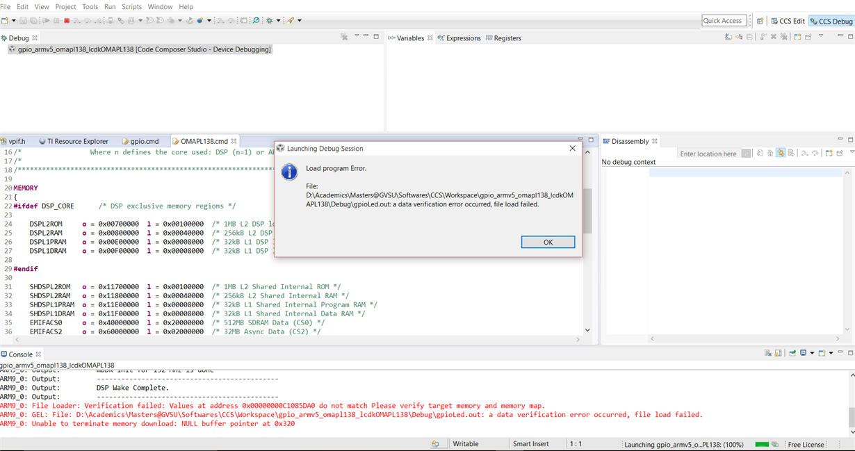

I have written some simple code for ARM (all my code runs) and now I want to do the same things on the DSP.
Now I have written something (Some Codesnippets are from the examples from TI) but It don't work right.
The programm should write on the console a 0 when the Userbutton is pressed else it should stand a 1.
I can compile and run the code, but i dont hav e a 0/1 i always have 15730432...(On the Console at the Desktop - Putty)
later I want the LED also to be On/Off if the button is On/Off (Also in the code but at the moment // or /**/)
I have CSS 5.4, OMAPL138 LCDK and the code is NOT for SYSBIOS

 Hope Someone can  me help.
Sorry for my bad english...
Greetz Fernando
  • Hi Greetz,
    Have a try the following code.

  • Yes Titus,
    I created a new project and added the code. Which project are you talking about? The GPIO starterware one? I am going to try on that. I'll let you know.
    Btw as a continuation of last post: I had the corresponding GPIOs for the LEDs toggling in the debug register window, but not on the real H/W. This has happened to me many times with other codes also. What could be the main reason for this?
    thanks

  • Titus,
    Like you said, I copied this code into gpio_arm starterware example (and excluded my original gpio.c from building in CCS). And I didnt change anything else. It was then that I got this "Data Verification error". So I changed my original GPIO.cmd file to omapl138.cmd linker file by changing the device in build settings from "Generic ARM9 device" to "OMAPL138LCDK". This resolved the data verification error, and I was able to debug the code. But I was still not getting the LEDs to blink on H/W. (They do toggle in software). What could be the issue? pls help
    Vivek
  • I am working with the LCDK board. and yes I can see all 4 LEDs toggling in the register window but not in H/W. This happens only when I need to pinmux. The basic gpio example works fine because of the built in pinmux function that comes with lcdk library. but when i try to do pinmux myself it doesnt work.
  • I think, you are working with ARM project.
    I have experience the similar issue.
    If so, you must use "system_config.lib" in your project.
    Refer to the following e2e posts.
    e2e.ti.com/.../1553176
    e2e.ti.com/.../1205114
  • Thanks a lot titus. I got the code working.
    The data verification error was resolved when I added GEL files for ARM and DSP each to my launch configuration.
    thanks again
