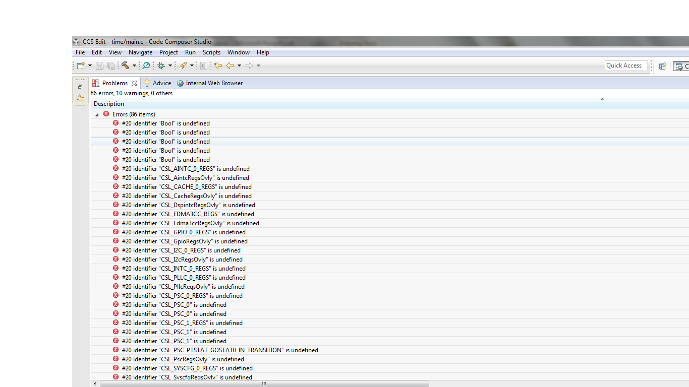

Dear sir,
I am working with standard code given by texas " C:\Program Files\Texas Instruments\quickStartOMAPL1x_rCSL\OMAPL1x\rCSL_examples\evmOMAPL137\DSP_examples\timer\TIMER_led_blink_frequency_dspL137\src"
I have created new project (not RTS) ,added headers and linkers
•Include:"C:\Program Files\Texas Instruments\quickStartOMAPL1x_rCSL\OMAPL1x\support\includes“
•Linker:"C:\Program Files\Texas Instruments\quickStartOMAPL1x_rCSL\OMAPL1x\support\cmd\OMAPL137_DSP.cmd"
But still, am getting errors like "boolean and other fikes" not defined.
I just imported the same timer .ccs project file from that location and extracted and i include the file which is in the standard example(TIMER_led_blink_frequency_dspL137) to my newly created project......i checked each any every properties of it and change it to my project...
(in stanard example predefined symbol=OMAPL137  but in my project by default it is "omapl137 is in lower case,i changed to upper case)...here is my code and error attachment.

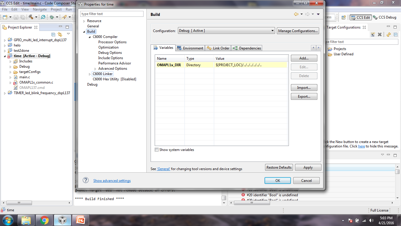

  • Hi Titus,
    As per my knowledge,i have installed all texas softwares in default locaiton only and am not at all changing any parameters(location of installaiton).I have done comparing with the standard project and my project i found..
    In standard project --->>>in resource->linked resource,i have four things .But in my project ---->>in the same place ,i have NOTHING.please see the attachment.  .
    In standard project --->>>in Buitld->c6000 compiler->optimization->optimization leve=3,But in my project ---->>in the same place ,i have NONE,I changed to 3.
    In standard project --->>>in general->variant->generic c6747 device.but in my had omapl137.i changed to generic c6747 device.
    In standard project --->>>IN BUILD->variables,it was OMAPL1x_DIR,But in my project ---->>in the same place ,i have NOTHING.but i changed to it.
    but result is same.....wat to do with this...

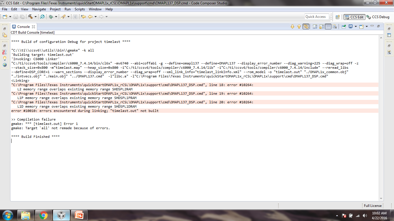

    1)I was trying the way what u said,but i am getting different errors,like
    L1P memory range overlaps existing memory range SHDSPL1PRAM
     L2 memory range overlaps existing memory range SHDSPL2RAM
    1D memory range overlaps existing memory range SHDSPL1DRAM
    what do you mean by this,would i need to incease or decrese or change the memory range....?.....

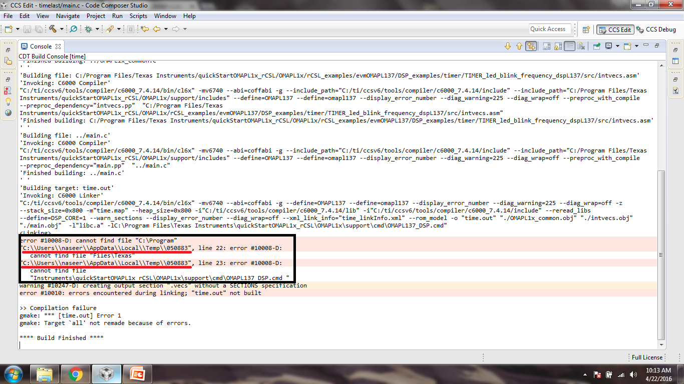

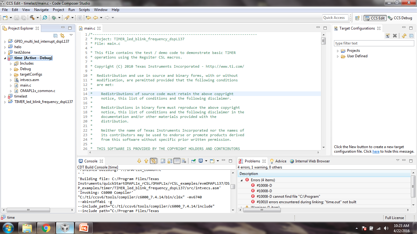

    2)I have collected the zip file what u attached in last conversion,as u said changed the path of "intvecs.asm" file and "OMAPL137_DSP.cmd" file,as well as INCLUDE files,in compiler section of properties,but still i am getting error like
    cannot find file:c\program,but my program not all include this path,still it is showing this,what is the reason.
    and other error is ,
    C:\\Users\\naseer\\AppData\\Local\\Temp\\050883", line 22: error #10008-D:
    cannot find file "Files\Texas",     no where my program related to this path,then why it is showing this path.
    I downloaded the the zip file,and extracted.Then i deleted older one with the same name in workspace and copied this (your zip downloaded)program to workspace and imported.
  • 1) Delete the OMAPL137.cmd file from your project and do Rebuild the project.
    2) Try to Rebuild the project (it may have some older location from earlier build)
  • Hi Titus,
    1)Thanks for your promt reply with long conversation,It works fine after removing the "OMAPL137.cmd",what was the reason........?i dint get why i got this errors.
    2)I did rebuild,but result is same.....with same errors.....
    thank you
  • 1) Its due to you have used multiple *.cmd file, if you look into library setting, already "OMAPL137_DSP.cmd" file is used.
    2) I don't what you have done to this project, so not able to predict the issue here.
