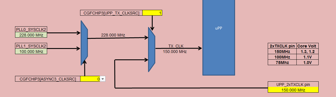

We have an OMAP-L138 processor, whose DSP has a uPP interface with an FPGA.
So far, we have been working at a clock rate of 300 MHz (which makes the uPP module and transmit clocks 150 MHz, according to the Technical Reference Guide and the Clock Calculator Excel sheet), and our interface with FPGA was working properly.
Recently, we have switched to a new board that supports the 456-MHz setting, so we changed the PLL controllers such that the DSP is now running at 456 MHz (which makes the module clock 228 MHz (fixed ratio, cannot be changed), but we maintain the transmit clock at 150 MHz). In this setting, when sending data from the DSP to FPGA, uPP occasionally throws a "Channel Q underrun/overflow interrupt", which would never occur at 300 MHz.

  • My PLL configuration is as follows:
    Chip configuration...

    This suggests ASYNC3_CLKSRC = 1 and UPP_TX_CLKSRC = 0.
    I already used the Excel datasheet. According to my configuration, the uPP clocks look like:
    My question is: how could raising the module clock to 228 MHz possibly lead to overflow/underrun errors? And how can I avoid this? I know I can't lower the PLL0_SYSCLK2 back to 150 MHz without reverting the DSP clock to 300 MHz.

  • Hi Silacko
    Thanks for clarifying that you were already using PLL clocking spreadsheet ( I missed that).
    Have you tried
    CFGCHIP3.UPP_TX_CLKSRC = 1 and CFGCHIP3.ASYC3_CLKSRC= 0 instead?
    I think as long as the IO clocks for uPP are as per the datasheet timing requirements , it should be ok.
    I do not know why you are choosing CFGCHIP3.ASYNC3 clock source to be PLL1_SYSCLK2 ? Was this the configuration for your previous 300 MHz setup too?
    ASYNC3 at 150 (instead of 228) will impact the following peripherals :ECAPs, UART1/2, Timer64P2/3, eHRPWMs, McBSPs, McASP0, SPI1
    (details in the clocking chapter in TRM)
    I do not know if these periphs are having any indirect impact on your system to cause overflow/underrun errors?
    I am assuming you have probed the IO clocks to ensure you are seeing the clock speeds to be as expected (in line with datsheet IO timings) and what you had in your 300 MHz setup?
    228 MHz internal module clock to UPP module should be ok , but IOs frequency (CH_CLKn) should be max as per datasheet timing.
    Mukul
