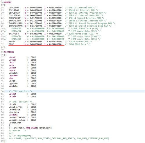

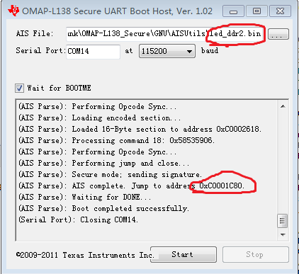

then I  do an experiment, in this experiment , I try to include the function DEVICE_ExternalMemInit(, , , , ,) ( PSC1_LPSC_SyncReset(PD0, LPSC_DDR) is called inside) in my application to configure the DDR.
then build it , produce a led.bin according the OMAP-L138_generic_secure.ini above, boot it  from the UART2 .
but it failed, no matter the DDR register in the function  DEVICE_ExternalMemInit(, , , , ,) is set the same as DDR register in the LCDK's gel or the results by mDDR_DDR2_Memory_Controller_Register_Calc_Rev5 tools.
it did't work unless you remove the configuration DDR function(that is,remove the function DEVICE_ExternalMemInit). I think maybe it still be the PSC1_LPSC_SyncReset  fault.
Now, I'm very confused about that, Where is the problem? How can I configure the DDR with the secure enabled C6748?

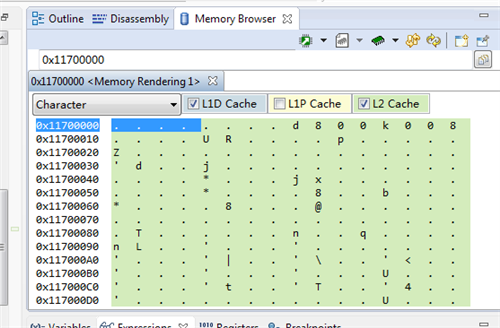

    Case 2: You boot an image over UART and blink LED and this code boots fine and you can see the LED blinking.
    Question : Is the code loaded in DDR or is the bootROM only initializing DDR but not placing code in it.  Did you check the DDR PSC and the EMIF registers to see if the DDR was configured as you expected from the INI file
    Answer 2:  According to the several pictures in Case 1, I believe that the code is loaded in DDR and run in it.

    Now, I guess I found the reason.
    When I run the application in DDR , I found the program can pass DEVICE_PLL0Init, but it would hang where DEVICE_PLL1Init  appear(Debug mode), it is because DDR clock is sourced from PLL1, when the program is runing in DDR, You may not be able to change its own clock .
    When I run the application in SHRAM, I found the program can pass both DEVICE_PLL0Init and DEVICE_PLL1Init, but it would hang in DEVICE_ExternalMemInit(), Specifically it is DEVICE_LPSCTransition(PSCNUM1, LPSC_EMIFB, PD0, PSC_SYNCRESET) that block the progress. The state transition could't complete in PSC1.
    No matter the program run in DDR or SHRAM, They both belong to PSC1,  maybe they can't change their own PSC1 state to SYNCRESET .
    For my secure enabled C6748, when I use boot image to unlock JTAG, the DDR2 is set at the same time, then the gel file is regard as a software program, so it can't be converted to SYNCRESET state. IF you reset the secure enabled C6748 ,then the JTAG will be locked.That is , the gel file can't be loaded when the secure enabled C6748 stay reset state. I can only configure the DDR  according to INI file.
    Do you think so?
