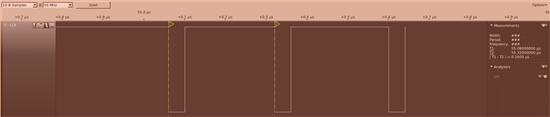

Anyway, now I have implemented 4 bit GPIO bitbanged read for Micron 25Q032 flash memory. The problem is that GPIO bitbanging is not fast enough. 25Q032 accepts clock upto 108 MHz, however I am very far from there with bitbanging.
From attached picture can be seen that toggling pin takes ca 40 ns, however reading GPIO pin value takes 260 ns. Question is how is reading so slow compared to writing? C6748 GPIO datasheet http://www.ti.com/lit/ug/sprufl8b/sprufl8b.pdf says (page 15) that reading GPIO is synchronized to GPIO clock, which is SYSCLK4. I am running DSP with 300 MHz clock, so SYSCLK4 should be 75 MHz. C6748 datasheet page 256 http://www.ti.com/lit/ds/symlink/tms320c6748.pdf shows some GPIO timing diagrams. I read out from there that minimum toggle time is 2C, where C is GPIO clock period. With 75 MHz it would be 2 + 13 = 26 ns. My logic analyzer does not sample fast enough to get such resolution. So I guess actually this 40 ns pin toggle what I measured could be less. Lets assume write also needs to synchronized with clock, then it is almost according to datasheet. I expect read to happen also within something around 30-40 ns, however it takes more like 260 ns. Which seems to be out of spec.

My question is: is it optimal? So is it rather hardware delay not software, although my interpretation from datasheet says that it should be faster from hardware point of view.
Andres
EDIT: I did not notice this before:
GPIx duration must be extended to allow the device enough time to access the GPIO register through the internal bus.
So actual read is 2C + bus time. I guess it is so slow because of bus time and there is nothing I can do about it.

    May be, you are true that, GPIO read duration is not optimal according to spec. but in general, toggling of the GPIO from write to read seems slower because the read portion is wait-stated and since the peripheral frame has "write-followed-by-read pipeline protection" the next read won't occur until the previous write has completed.
    Also, you are right, it would have consumed more bus time of GPIx duration and it would have made GPIO read very slow than the actual. I guess, there could also be delay because of software GPIO programming sequence using starter ware API's too and please ensure that it is configured appropriately. Please check the programming sequence for the starterware GPIO in the below wiki:
