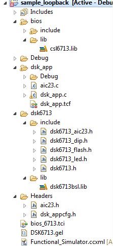

now i am trying to use existing sample codes dskapp which does the same job, but as these projects are been built using CCS3.1 or 3.3 i think, i am not able migrate the project to CCSv5 properly
i have read enough wiki pages which are not that helpful in resolving issues, kindly if you have time take a sample project which one among these
kindly if you have time take a sample project called dskapp,  which one among these and try, then
path :DSK6713\examples\dsk6713\bsl\dsk_app
location to download from : c6000.spectrumdigital.com/.../dsk6713revc_files.zip
the problem its completely unclear which files to be included and what to be not, as i am not aware of CCS3.3 there are few files which are actually have a comment header sayinng they are auto generated

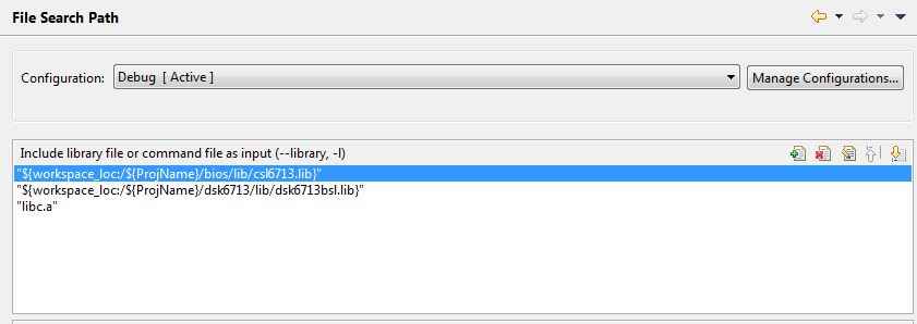

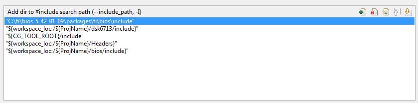

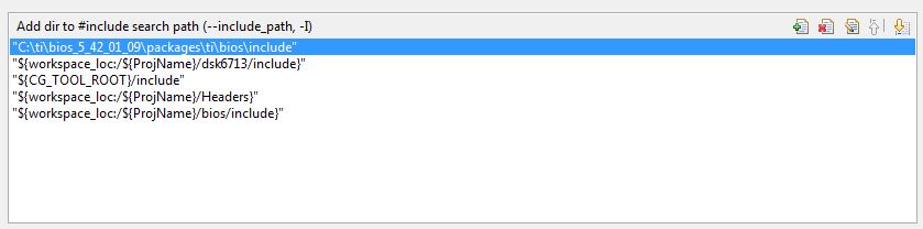

i included all CSL and BSL includes and libraries possible, but could not resolve the below errro
kindly provide the necessary path to download the library needed, i have installed bios also but not sure what is to added as necessary library to solve that, i am clue less

"C:/ti/ccsv5/tools/compiler/c6000_7.4.4/bin/cl6x" -mv6700 --abi=coffabi -g --define=CHIP_C6713 --display_error_number --diag_warning=225 --diag_wrap=off -z -m"sample_loopback.map" -i"C:/ti/ccsv5/tools/compiler/c6000_7.4.4/lib" -i"C:/ti/ccsv5/tools/compiler/c6000_7.4.4/include" --reread_libs --warn_sections --display_error_number --diag_wrap=off --xml_link_info="sample_loopback_linkInfo.xml" --rom_model -o "sample_loopback.out" "./dsk_app/dsk_app.obj" "./dsk_app/aic23.obj" "../dsk6713/lib/dsk6713bsl.lib" "../bios/lib/csl6713.lib" -l"C:\Users\xyz\workspace_v5_5\sample_loopback\bios\lib\csl6713.lib" -l"C:\Users\xyz\workspace_v5_5\sample_loopback\dsk6713\lib\dsk6713bsl.lib" -l"libc.a"

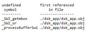

undefined first referenced
symbol in file
_SWI_getmbox ./dsk_app/dsk_app.obj
_SWI_or ./dsk_app/dsk_app.obj
_processBufferSwi ./dsk_app/dsk_app.obj
error #10234-D: unresolved symbols remain
error #10010: errors encountered during linking; "sample_loopback.out" not built
