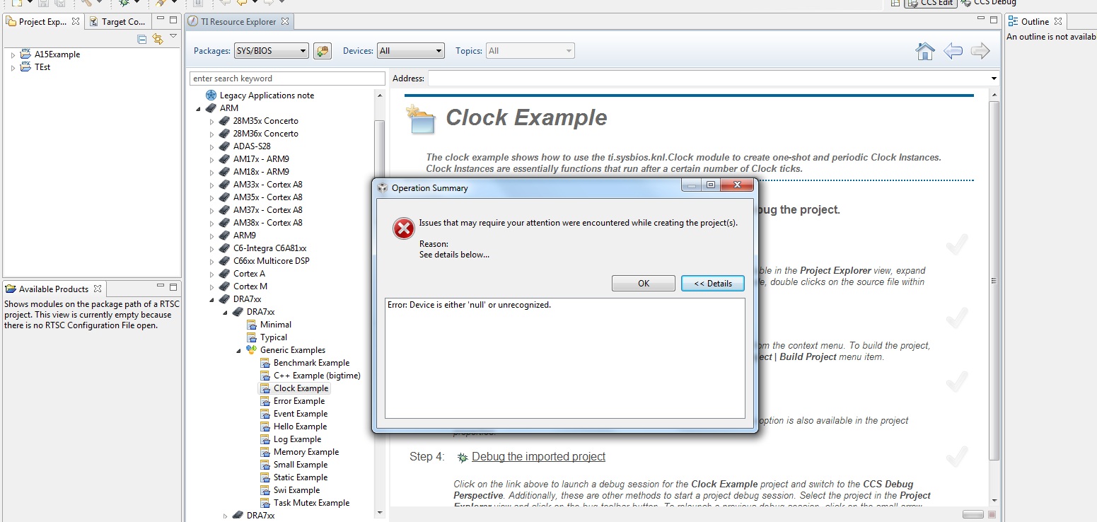

  • Hi Judah,
    I my installation crashed so I can expect unexpected behavior (see attachment)?
    For CCS5.5 you enforced to promote the TI Resource Explorer rather than of selecting a template during new project creation (Menu>Project>New CCS Project). How come no advanced SYSBIOS templates are displayed anymore?
    Using TI Resource Explorer the specific examples are display.
    Thorsten
  • Hi Judah,
    creating a project for A15 going the (Menu>Project>New CCS Project) path I was able to build. Even I can see the print out on the console (semi host result).
    However, still using TI Resource Explorer offers the complete set of examples. But I could build successfully using it. I give it another try.
    Thorsten
  • Hi Judah,
    it turned out following the process discribed in the wiki is functional as long as you take TI814x an A8. If you do so for ADAS-S28 it doesn't. I would expect that all the processors displayed in the TI Resource Explorer should be functional? NO?
    http://processors.wiki.ti.com/index.php/SYS/BIOS_with_GCC_%28CortexA%29#How_does_variable_initialization_work_in_SYS.2FBIOS_applications_built_for_GNU_targets_.3F
