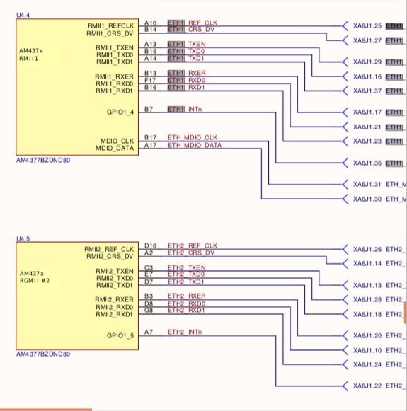

Hi all,
I am using custom board based om am437x processor. I have done changes on top of ti-linux-sdk-04.00.00.04. mdio PHY is getting detected at address 1 and 2, but link is down no negotiation is happening. Link led is also not glowing, it doesn't getting any IP address. Here i have attached the required details.
  root@am437x-evm:~# uname -a
Linux am437x-evm 4.9.28-geed43d1050 #7 PREEMPT Fri Sep 1 20:15:16 IST 2017 armv7l GNU/Linux
root@am437x-evm:~# ethtool eth0
Settings for eth0:
        Supported ports: [ TP MII ]
        Supported link modes:   10baseT/Half 10baseT/Full
                                100baseT/Half 100baseT/Full
        Supported pause frame use: No
        Supports auto-negotiation: Yes
        Advertised link modes:  10baseT/Half 10baseT/Full
        Advertised pause frame use: No
        Advertised auto-negotiation: Yes
        Speed: 10Mb/s
        Duplex: Half
        Port: MII
        PHYAD: 1
        Transceiver: external
        Auto-negotiation: on
        Supports Wake-on: d
        Wake-on: d
        Current message level: 0x00000000 (0)
        Link detected: no

root@am437x-evm:~# ifconfig eth0
eth0      Link encap:Ethernet  HWaddr C4:BE:84:CB:5E:69
          UP BROADCAST MULTICAST  MTU:1500  Metric:1
          RX packets:0 errors:0 dropped:0 overruns:0 frame:0
          TX packets:0 errors:0 dropped:0 overruns:0 carrier:0
          collisions:0 txqueuelen:1000
          RX bytes:0 (0.0 B)  TX bytes:0 (0.0 B)
          Interrupt:139
root@am437x-evm:~#

	/* Ethernet pin-mux for  GC150 */
	ethernet_phy_pins_default: ethernet_phy_pins_default {
		pinctrl-single,pins = <
		/* phy 1 */
			AM4372_IOPAD(0x90c, PIN_INPUT | MUX_MODE1 )  /* (B14) mii1_crs.rmii1_crs_dv */
			AM4372_IOPAD(0x910, PIN_INPUT | MUX_MODE1 )  /* (B13) mii1_rx_er.rmii1_rxer */
			AM4372_IOPAD(0x914, PIN_OUTPUT | MUX_MODE1 ) /* (A13) mii1_tx_en.rmii1_txen */
			AM4372_IOPAD(0x924, PIN_OUTPUT | MUX_MODE1 ) /* (A14) mii1_txd1.rmii1_txd1 */
			AM4372_IOPAD(0x928, PIN_OUTPUT | MUX_MODE1 ) /* (B15) mii1_txd0.rmii1_txd0 */
			AM4372_IOPAD(0x93c, PIN_INPUT | MUX_MODE1 )  /* (B16) mii1_rxd1.rmii1_rxd1 */
			AM4372_IOPAD(0x940, PIN_INPUT | MUX_MODE1 )  /* (F17) mii1_rxd0.rmii1_rxd0 */
			AM4372_IOPAD(0x944, PIN_INPUT | MUX_MODE0 )  /*(A16) rmii1_ref_clk.rmii1_refclk*/
		/* phy 2 */
			AM4372_IOPAD(0x840, PIN_OUTPUT | MUX_MODE3 ) /* (C3) gpmc_a0.rmii2_txen */
			AM4372_IOPAD(0x850, PIN_OUTPUT | MUX_MODE3 ) /* (D7) gpmc_a4.rmii2_txd1 */
			AM4372_IOPAD(0x854, PIN_OUTPUT | MUX_MODE3 ) /* (E7) gpmc_a5.rmii2_txd0 */
			AM4372_IOPAD(0x86c, PIN_INPUT | MUX_MODE3 )  /* (D8) gpmc_a11.rmii2_rxd0 */
			AM4372_IOPAD(0x868, PIN_INPUT | MUX_MODE3 )  /* (G8) gpmc_a10.rmii2_rxd1 */
			AM4372_IOPAD(0x870, PIN_INPUT | MUX_MODE3 )  /* (A2) gpmc_wait0.rmii2_crs_dv */
			AM4372_IOPAD(0x874, PIN_INPUT | MUX_MODE3 )  /* (B3) gpmc_wpn.rmii2_rxer */
			AM4372_IOPAD(0x908, PIN_INPUT | MUX_MODE1 )  /* (D16) mii1_col.rmii2_refclk */

  • Hi Vimal,
    What HW changes you have between AM437x EVM and your custom board regarding ethernet? Do you use the same pins?
    The AM437x GP EVM has a 10/100/1000 Ethernet transceiver from Micrel (KSZ9031RN). The reset on the transceiver is driven by the board system reset signal SYS_RESETn. A 25-MHz crystal drives the clock input of the KSZ9031RN Ethernet PHY.
    The PHY address is set to 0x00h.
    Are you able to get IP address in u-boot? I would suggest you to first check how ethernet works in u-boot, then you can switch to linux kernel.
    Pavel
    The pins used are different. I am using both the ethernet in RMII mode. i have included a image showing pin connections.
    sometime Link is getting detected and its up connected to 100Mbps but there is no ip address. Green led is not glowing.
    Orange led continuously blinking. Here is console output.
    root@am437x-evm:~# [ 388.409608] cpsw 4a100000.ethernet eth0: Link is Up - 100Mbps/Full - flow control rx/tx
    [ 388.417775] IPv6: ADDRCONF(NETDEV_CHANGE): eth0: link becomes ready

  • I would suggest you to first check how ethernet works in u-boot, then you can switch to linux kernel.
    Check from user space (when linux kernel boot up finished) that your etherent pins are setup correctly and as expected.
    AM437x TI EVM is using RGMII mode, thus the default SDK comes with that mode enabled. Make sure you have switch from RGMII to RMII in lunux kernel code.
    P.S. It will be easier to debug that issue if you first try ethernet at u-boot stage.
    Pavel
  • Thanks for the reply. There is clock issue from hardware itself. We fixed that and now I am able to get Ethernet up.
    It's not fully working but I am able to get ip address and ping is happening. There is packet loss while pinging...and still link led is not up...We are  looking after it.
