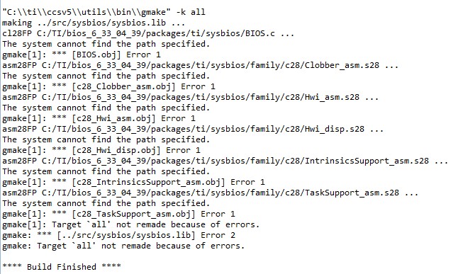

  • I'm also getting the folowing error when I compile now:
    Ed
  • More information:
    I went back to Sys/Bios version 6.33.5.46 and thing are a bit better.  I no longer get XDC error when I compile and the app.cfg file now seems to be OK.  However now I'm back to the sysetm not being able to find some files.
    Ed
    making ../src/sysbios/sysbios.lib ...
    cl28FP C:/TI/bios_6_33_04_39/packages/ti/sysbios/BIOS.c ...
    The system cannot find the path specified.
    gmake[1]: *** [BIOS.obj] Error 1
    asm28FP C:/TI/bios_6_33_04_39/packages/ti/sysbios/family/c28/Clobber_asm.s28 ...
    gmake[1]: *** [c28_Clobber_asm.obj] Error 1
    asm28FP C:/TI/bios_6_33_04_39/packages/ti/sysbios/family/c28/Hwi_asm.s28 ...
    gmake[1]: *** [c28_Hwi_asm.obj] Error 1
    asm28FP C:/TI/bios_6_33_04_39/packages/ti/sysbios/family/c28/Hwi_disp.s28 ...
    gmake[1]: *** [c28_Hwi_disp.obj] Error 1
    asm28FP C:/TI/bios_6_33_04_39/packages/ti/sysbios/family/c28/IntrinsicsSupport_asm.s28 ...
    gmake[1]: *** [c28_IntrinsicsSupport_asm.obj] Error 1
    asm28FP C:/TI/bios_6_33_04_39/packages/ti/sysbios/family/c28/TaskSupport_asm.s28 ...
    gmake[1]: *** [c28_TaskSupport_asm.obj] Error 1
    gmake[1]: Target `all' not remade because of errors.
    gmake: *** [../src/sysbios/sysbios.lib] Error 2
  • I've tried using older version of code composer, XDC tools and the C2000 compiler.  All seem to give the same result now (same as above)
    Ed
  • Ed,
    many of the errors in a couple of your last posts can be a result of the project being in an invalid state due to previous building errors. Additionally, when you turn on the generation of the PPM file, the build will stop there. So, whenever you need to create a PPM file, you have to turn that option on, create the file and then turn the option off. Also, from the PPM file you posted I can see that the macro xdc__strict wasn't in effect when you created that file. We have to check why that happened.
    First, clean the project and check the output in the console window to verify that the cleaning succeeds. Also, find your project directory in Windows Explorer and remove the directory .config. It's a temporary directory that will be regenerated when needed.
    Now, select XDCtools and SYS/BIOS in the version of CCS in which you worked at the beginning of the thread. Open the file Injector_test.c and verify that you have these lines in your file in this order:
    #define xdc__strict
    #include <xdc/std.h>
    Try building and post the console output. If the build fails, clean the project, turn on the generation of the PPM file, and build again. Please post the generated PPM file for Injector_test.c.
    Just to be safe, whenever you make a change after a build fails, clean the project before a new build. That way you won't chase the problems that are simply a result of a previous failed build.
  • Sasha,
    Thanks for the update.  However I managed to fix the issue, although I'm not sure what happened.  As far as I can tell, my CFG file was corrupted some how.  What I did was create a new project from scratch and copied all my source in and then added all the SYS/Bios components manually.  Took me a while but it is now working with:
    CCS version 5.4
    C2000 Compiler version 6.1.3
    Sys/Bios 6.35.1.29
    XDC Tool Version 3.25.0.48
    I think that is all the newest components.
    Thanks for the help but I think I will move on with the new build.  I wish I knew what happened.
