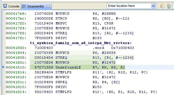

It worked for a while, then after a project rebuild command it stopped working, with execution stucked here:
          ti_sysbios_family_arm_a8_intcps_Hwi_vectors
I see a funny assembly instruction called "UndefinedLE" that endlessly jumps back to address 0x8041800:
I really can't explain why did it worked properly (tested with a nice and clean led toggle inside HWI function), then suddenly stopped after a project rebuild...

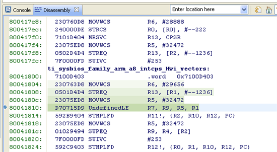

Same as previous:
This occurs *before* the timer initialization...
So I removed the DMTimer3ModuleClkConfig() function call in hardware initialization: It should be there because DMTimer3 module is not initialized by sysbios (is this statement correct?), but it seems that its presence cause that kind of problem.
No ti_sysbios_family_arm_a8_intcps_Hwi_vectors exception occurs, but timer is not running and my_dmtimer_hwi  function is never called.

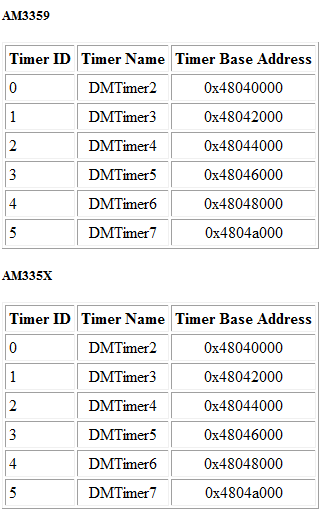

    There is one problem  in your HAL based implementation. The timer ID passed to Timer_create function is  3, however, id has to be 1 for DMTIMER3. See below given table ( Taken from SYS/BIOS help )
    I'm using the below given code to have a timer in my application and it is working perfectly for me.  You might want to give a try..

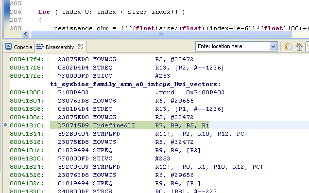

    I've increased stack size (65535 bytes) but everything is always stuck here:
    Does someone know what (TF) is that? Why cpu sometime reach that? Why sysbios does not initialize it (assuming it's something that has to be initialized)?
