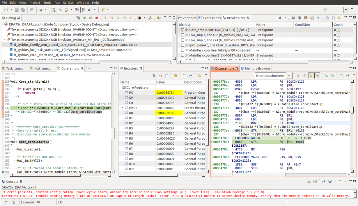

However, there is nothing that prevent the compiler from doing the store to set the stack pointer AFTER the store to set the instruction pointer. This is what happened in my case (TI compiler v5.1.11). See the disassembly view:

    But I’m wondering now if this is a real problem today.  Are you seeing an actual issue when running, or is this based on analyzing the reordering in the disassembly view?
    I ask because after core 0 writes to 0xC, there is only one intervening instruction before the write to 0x8.  Meanwhile on core 1, after the “ldr r0, core1vec” where the new value is loaded, there will be the compare, check, and resetting of the value for next reset, resulting in 5 intervening instructions before the “ldr sp, core1sp”.  If both CPUs are executing in parallel it seems that the proper SP value would still be read on core 1, even though it was written second by core 0.
    I think it would probably be good to insert a barrier instruction to be extra safe, especially if this code changes in the future and there is opportunity for additional reordering and insertion of other instructions on core 0.  But I’m wondering if it is a real problem today.  Am I missing something?

    I'm currently having problems with the startup of SysBios on my platform and I'm totally unsure what it is. There is probably something else broken, not necessarily what I reported here - maybe in my code, maybe in my SysBIOS configuration. I just stumbled across this issue so I thought I'd better report it.
    As you already mentioned, the chances may not be very high that the issue occurs. Maybe it always works. I will try the "DMB"-fix and will let you know.
    What I currently see is that after startup I hit the breakpoint in the main()-function. There I create one task with Task_create() and then call BIOS_start(). However, the breakpoint in the very first line of my task is never hit and the CPU gets an ARM hard fault somewhere in between. That's why I started debugging what actually going on after BIOS_start().
