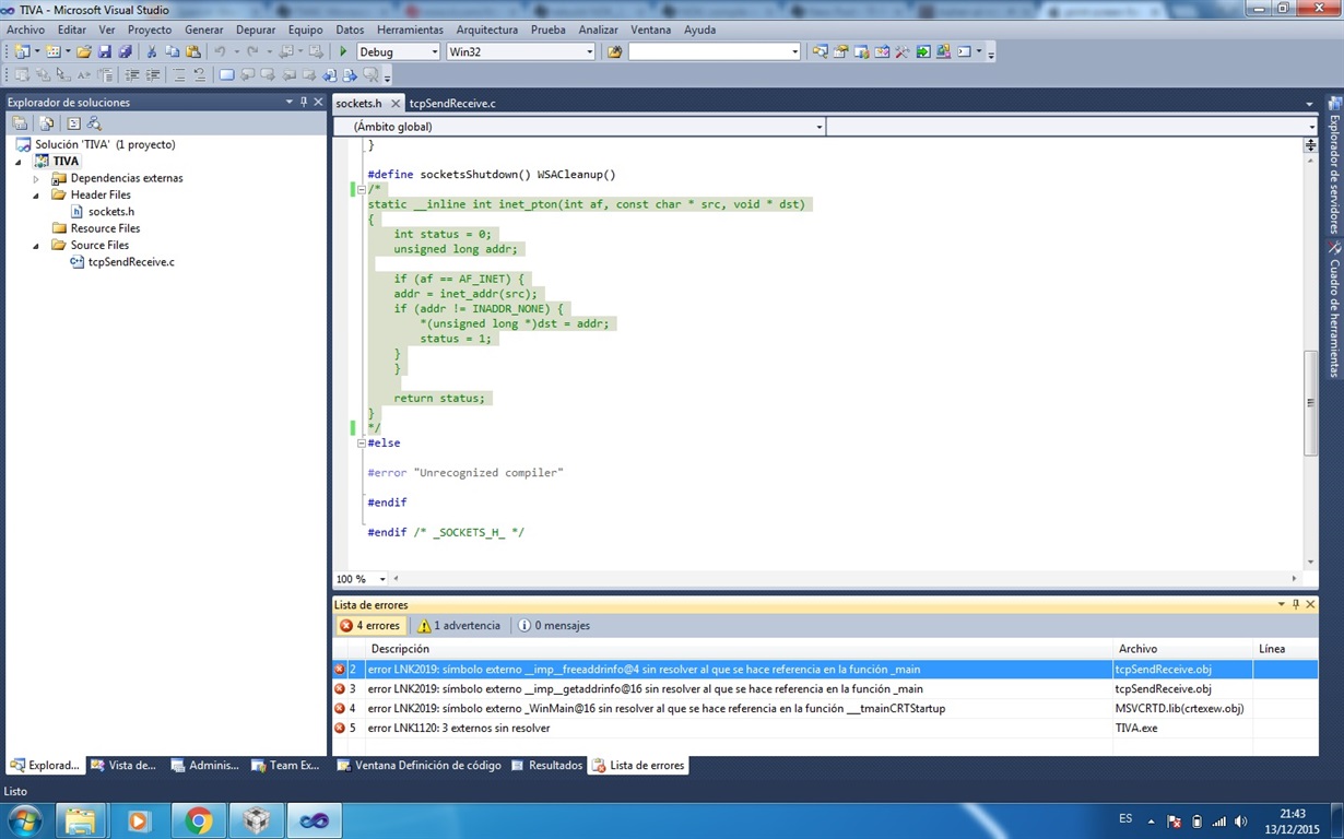

I'd like to rebuild the tcpSendReceive.c file in the directory C:\ti\tirtos_tivac_2_14_04_31\packages\examples\tools. The idea is to use it to communicate with the TIVA C Connected EK-TM4C1294XL evaluation kit running the tcpEcho firmware example. When I use the previuosly built executable file, it works fine. I'd like to rebuild it again using Microsoft's VC 2010. I created a project based on the files in the tools directory above and added the wsock32.lib to the additional dependencies
I followed the instructions found in this page, but it doesn't work. I usually receive this error code:
Error 1 error C2373: 'inet_pton' : nueva definición; modificadores de tipo distintos c:\users\awefky\desktop\ethernet_tiva\sw\2015_12_12\tools\sockets.h 56.
In English, this means that the function "inet_pton" found at line 56 in sockets.h header file has been defined again! When I tried to comment out that definition in the sockets.h file, I get the 4 errors shown in the attached screen shot.

    The socket.h file was written to be used for both Linux and Windows. We use Mingw gcc compiler to build the original executable. I can ask around for someone who's done it on Visual Studio to help better. It looks like you're missing some library that has those symbols. From Googling online I see that freeaddrinfo is part of the Ws2_32.dll or previously wsock32.lib for example. Can you check what libraries you're pulling in to build your project?

    Thanks a lot for your informative response. Now the program is working perfectly. I changed the library I'm building against in Visual studio from wsock32.lib to Ws2_32.lib in light of your comment and finally I could bulid my project. The other important point here also is that I couldn't do so without commenting out the inet_pton() inline function in sockets.h.
