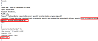

Dear TI team,
We are unable to order the part available in stock with the TI store right now. Please find the order API error response highlighted below.
Also please note the part is observed to be in stock with Qty 2400 as of now. Earliest response shall help us get me the required quantity.

"errors":
"errorCode": "ERR-TICOM-ORDER-API-0004",
"type": "Application",
"section": "lineItems",
"field": null,
"reason": "Part number(s) requested inventory quantity is not available per your request.",
"message": "Please check the inventory levels for available quantity and resubmit the request with different quantity. Note In instances of low inventory ordering limits may be set.",
"data":
"customerLineItemNumber": "1",
"tiPartNumber": "TPS549B22RVFR",
"quantity": "250",
"availableQuantity": "2400",
"limit": "50"
  • Hi Kushal,
    In the response you copied above, you'll see that there is an order limit of 50 on TPS549B22RVFR, so you're receiving the error because you are requesting more than 50 parts.
    Note that you can see the limit prior to attempting an order by calling the inventory and pricing API.
    I hope that helps.
