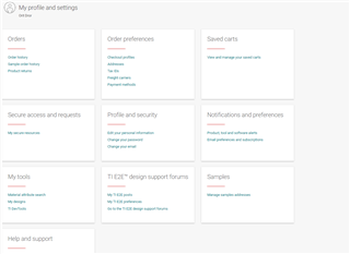

  • Dear Faye,
    It looks as if this issue is different. We used an incorrect API keys, however when attempting to request keys, we do not have this option on our dashboard, although the checkout profile was properly set up (see attached).
    Please advice.
    Semilogistics team
  • Hi Orit,
    You can only request API keys if you are logged in (or change role) to the "corporate" account.   From looking at your screen shot, it appears that you are logged in under a "personal" account (see first screen shot).   If you have permissions to generate the API Keys, you'll need to switch to the "corporate" account and operate under that account.  My second screen shot (bottom example) shows you how to check to see if you can switch to the corporate account.  If you only have access to your own dashboard (second screen shot - top example), then, you'll need to work with your system administrator to get the API keys generated.   Let me know if you have other questions!
