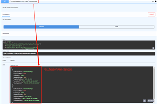

The Inventory subscriptions function cannot be accepted
I subscribed to two tiPartNumber,
Didn't send me a subscription message when it became available via post
我订阅了两个tiPartNumber, 当有货之后并没有通过post发送订阅信息通知我
I use Inventory subscriptions (test) tool to do post, which allows the application to accept relevant json data
我使用TI   Inventory subscriptions (test) 工具提交post,我设置的程序能接收到相关的json数据,说明我程序应该是正常的
When tiPartNumber was available, I did not receive the data of post. May I ask what caused this?
当tiPartNumber有货时,我并没有接收到post的数据,请问这种是什么原因引起的?

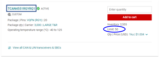

    我正在尝试翻译工具,因此可能不是100%准确。此时,您只能购买此部件的50件(请参见下面的屏幕图像)。一旦您购买了此限制,您将无法在30天内购买更多此部件。但是,对于此部件,您将无法订购3000。为了更好地使用库存订阅API,我们建议您将数量设置为1。收到TI的通知后,您可以尝试订购更多数量的产品。如果您有任何其他问题,请告知我们。
    I am trying a translation tool, so it may not be 100% accurate. At this time, you can only purchase 50 units of this part (see screen image below). Once you have purchased this limit, you will not be able to purchase more of this part for 30 days.  But, for this part, you will not be able to order 3000. In order to have greater success with the inventory subscription API, we recommend you set the quantity to 1.  Once you received the notification from TI, you can then try to order more quantity.    If you have any further questions, please let us know.
