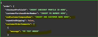

    in the order  json there are a few optional fields that your developer can utilize to pass such information- optional fields highlighted below, endCustomerCompanyName enter in company name or email address could be here it is a string. Then at the item levell - an option to use customerOrderComments " message" this could hold contact name, email address, phone number, buyer name, etc.

    In Checkout Profile is one email address in the shipping address, another email address is in the billing address. But these emails are sent to my email address that is not listed anywhere in the order. I don't believe the items highlighted in yellow can change that.
  • You are correct, you cannot, it would be informational - unless your admin or programmer when receiving the orders setups a crossreference to parse the info and then send email to your respective  email addresses or a group email  portal for you all to see the orders coming into your company account.
