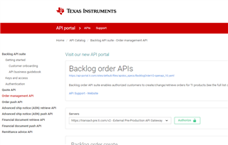

  • On our portal same area where you see the API business guidebook, click on the Order Management Suite API - Backlog API suite - Order management API | TI API Portal you will find the spec and their schema(s) are down below the API's - you can expand them to find fields, etc. this should be helpful to you.IS this what you are looking for?
  • Hi Tammy, what you mentioned is exactly what I am looking for. However, I still can't find where can user access the documentations.
    Documentation is not shown in the below link 'https://api-portal.ti.com/backlog-api-business-guidebook#push'
    And I've tried other ways to search, but no result at this moment.
    When I click the link in the bottom of the page to get to 'TI API Suite' I was able to find link to Backlog API suite but the site reject my visit.
    I was using the latest version of Chrome in Incognito mode and tried MS Edge (all cookie removed), but none of them worked.
  • David with our most recently upgrade to a different software platform for our documentation we are having a few issues getting the access set for customers to see - if you use this link and you are a v2 customer you can access the data from this link until the portal issue is resolved. api-portal.ti.com/.../backlog-api-suite - you must be logged into your account. then you shoudl be able to see this similar view to get to the schemas. down below the APIs
