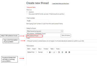

  • Lior,
    I would suggest clicking on one of these links for the API form:  (English or Chinese (中文).  If you use these links, the only items you'll need to complete are highlighted below.
