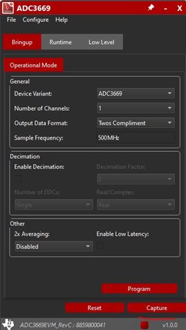

I am using eval board ADC3669EVM and capture board TSWDC155EVM. They require software "MSPS_FPGA_Server", "ADC3669EVM", and "High Speed Data Converter Pro".

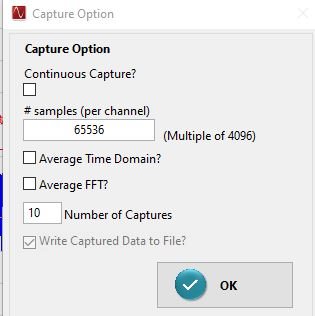

For the "High Speed Data Converter Pro" we have an incoming signal that is getting RF pulsed (not a single tone) with a span of 120MHz on the spec an. Typically we would run a "max hold" on the spec an since the spectrum occurs very quickly.
1) Is there a way to do a "max hold" on the "High Speed Data Converter Pro" so I can see the entire spectrum? Else I will need to continuously capture to get lucky.
2) I see there is a "capture option" in the "High Speed Data Converter Pro", are the check boxes "continuous capture" and "average FFT" still usable with the ADC3669EVM setup?
    Unfortunately no, these HSDC Pro features are not supported with the ADC3669EVM setup. We are no longer developing HSDC Pro and are in the process of moving over to a new capture software, which will hopefully be out within the next year. In the meantime, for newer devices like the ADC3669, we are using a quick fix solution that does not support all of the features of HSDC Pro.
