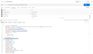

Developing API interface to receive Products data.
However I expect to receive 'Inventory Status' which seems to be blocked.
I keep getting 'Contact TI' for every item.
Please see screenshot below, marked in red.
I already set Inventory Subscription API in our account.

The query is:
https://transact.ti.com/v1/products/MSP430F2617TPM
I also attach here a screenshot with the result.
The InventoryStatus tag return "Contact TI"
Hi Oksana,
I need to do some checking on why the product information API is returning Contact TI for inventory status.
In the meantime, with the same credentials you can call the TI store inventory and pricing API to receive the actual inventory quantity value: https://transact.ti.com/v2/store/products/MSP430F2617TPM

Hi Oksana,
I've learned that the product information API will always return "Contact TI", and that the next release of the product API will remove that field from the response altogether.
The best way to retrieve product inventory data is to call the TI store inventory and pricing API as described previously (https://transact.ti.com/v2/store/products/MSP430F2617TPM)
You can find more details on the inventory and pricing API at https://api-portal.ti.com/inventory-pricing-api
Let us know if you have any concerns.
