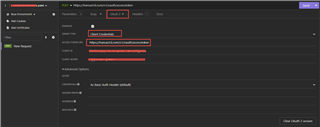

  • Hi Faye,
    using API key for "client_id" and API secret for "client_secret" in Insomnia, Diogo is receiving an error:
    Following the steps from this page: https://www.ti.com/developer-api/store-api/authentication.html
    Can you advise what could be leading to this error?

  • For information I've asked to generate a new key/secret and I got them immediately.
    So I've did a new test with those new codes and same issue.
    Here's the configuration for the moment on a post:
    (There's any space on the fields).
    Can you please confirm that the "client_id" is the API key received and the "client_secret" is the API secret?

    Removed the pic with your key/secret.

  • Hi Diogo,
    Your credentials look fine and you are approved for all of the TI Store APIs.   Please check your "POST" statement - it should reflect making a call to the appropriate API.  Below is a call to test the Order-create API.  Let me know if you still have problems.
