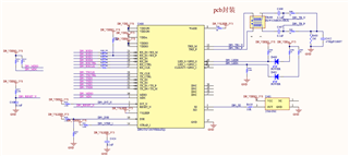

    1.The board is my own board,I connect the PHYs MDC/MDIO through FPGA,The schematic diagram is as follows

    I didn't use USB2MDIO.I connect the PHYs MDC/MDIO through FPGA,The schematic diagram is as follows
    I use FPGA to drive the SMI interface.
    Understood. Can you try and scope the lines then to see if the proper commands are coming out and reading back?
    Sincerely,
    Gerome
