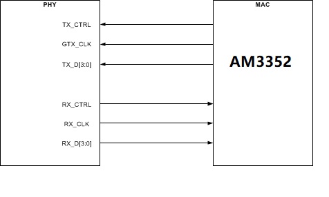

  • Hi Vikram,
    Thanks for your response.
    For 1/, yes, they are two boards in the same batch.
    For 2/, yes, some boards can even work for 16 hours or 20 hours.
    For 3. all the packets are transferred well at the very beginning, I draw a diagram below.

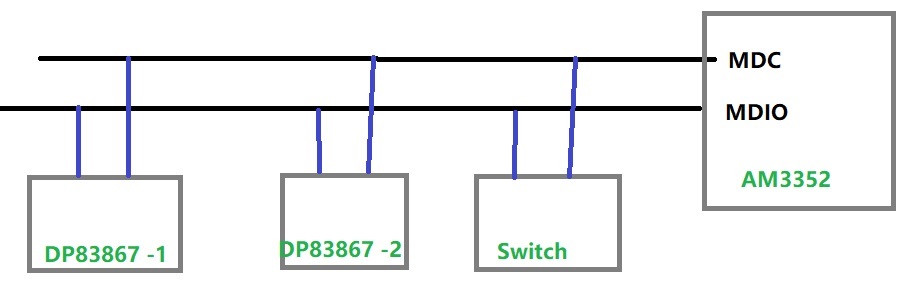

    There are two DP83867 and a switch connected with the same MDC/MDIO bus,
    - DP83867-1 is connected with public Gigabit network, and and it would be down after 6 hours or 10 hours.
    - DP83867-2 is connected with 100M network, at least I didn't find it down during days of testing.
    - The switch is also working well.
    Today I wrote some scripts inside linux of AM3352, so it will keep reading registers of DP83867-1, I'm using register 0x0003, it must be 0xA231 per datasheet page59, while in 10000 times reading, I found there would be about 30 times with value like 0x0110, or others, I'm one hundred percent of sure that the MDC/MDIO bus is pretty clean, no signal integrity problem, MDC is 1MHz, and MDIO will change in the falling edge of MDC.
    So my question is, given a device under MDC/MDIO bus, should I read 0xA231 all the times? Is it driver related issue?

    Regarding MDC/MDIO : Yes it should read correct value every time. What is the phy address of 867-1? Can you share the straps connected to pins to make this phy address possible? Also is MDC clock running continuously or does it stop after every read?
