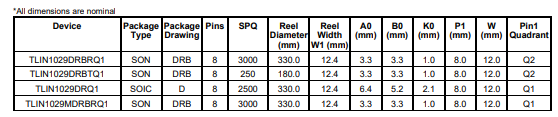

Here is the screen shot o page.33 of datasheet.
'TIN1029DRBRQ1' is top line and 'TLIN1029"M"DRBRQ1' is bottom line.
I cannot find any difference.
Could you explain more detail?

Yamamoto-san,
See the very last column, "Pin 1 Quadrant". TLIN1029DRBRQ1 has the pin 1 in Q2, while TLIN1029MDRBRQ1 as the pin 1 in Q1. This is referencing the image directly above this table in the datasheet, showing how the ICs are oriented in the tape and reel once they are delivered.
Does this make sense?

Yamamoto-san,
These tape and reels are used in automatic assembly machines, and so depending on the customer's setup, they may need the device oriented differently for their machine to assemble to part in the right place. I don't know the history on this particular case, but I'm guessing a few customers requested this orientation so we decided to make a separate orderable part number for it.
