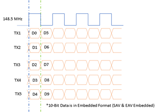

We have requested for the code but haven't received any update or mail from TI.
We just need to know the timing diagram and we can work on the code.
If our understanding is correct
1. we have to send 5 LSB's @ Posedge and next 5 MSB's @ Negedge
2. What is clock rate ? 148.5 MHz ?
Please suggest is our understanding is correct or share the code
