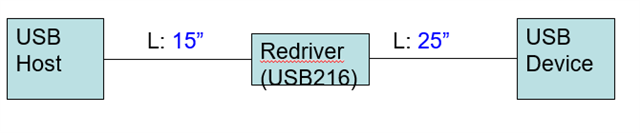

TUSB216: Topology Review[Wistron/Server]
Part Number: TUSB216
Please see attach file for topology review
From simulation report , the driving length of  USB Host is 20 inch.
Can you provide your recommend about below topology ?
From the capacity of USB host with USB216 can support 40 inch, but the location of redriver can’t on middle of 40 inch.
