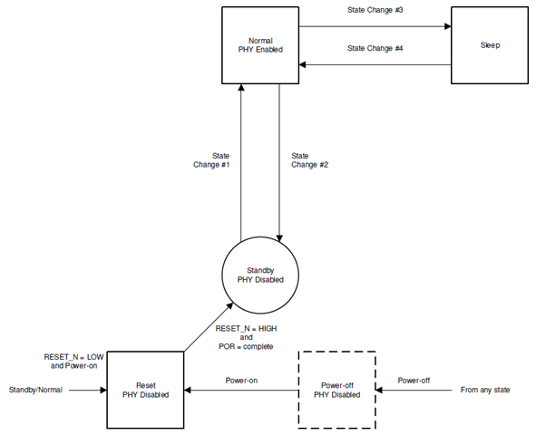

    I have questions about how to enter normal mode.
    From datasheet, power on will enter reset PHY disable → set RESET_N=High and POR complete will enter standby mode → If autonomous enable, standby mode will automatically enter Normal mode.
    My questions:
    • What is POR?
    • How to enable autonomous? Is it default?
    Thanks!
    Ethan Wen
  • POR is the internal power-up reset and is not visible to external world. Customer can just follow the power up sequence timing dictated in datasheet and need not worry about the POR.
    Autonomous mode is enabled by default. (no strap on led_1).
    So by default chip will power up in normal mode.
    For further quieries on different topics from the original kindly open a new thread so that it can be used better for tracking and reference by others.
