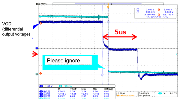

Hi Experts,
When the input of driver transients from high to low or low to high, there is about 5us idle state on Vod like below.
Is it expected behavior?

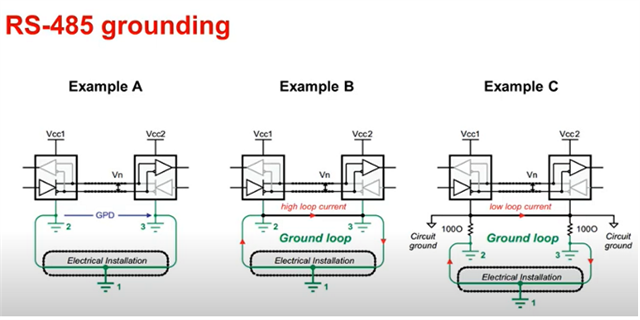

    How much cable is between SN75179 and the AM26LV32CDR? If there is a lot of cable between these two devices, I could see how a ground potential difference may be significant enough to effect the data cables, or even cause the transceivers to fail. This GPD could also affect the voltage across PTZ15B Zener diodes due to common mode voltage differences.
    Consider this grounding diagram:
    Note that as grounds shift due to communication across further distances, ground loops can occur affecting your data lines. Example A being the worst, example B is better but could cause data errors, and example C adhering to the RS485 standard.

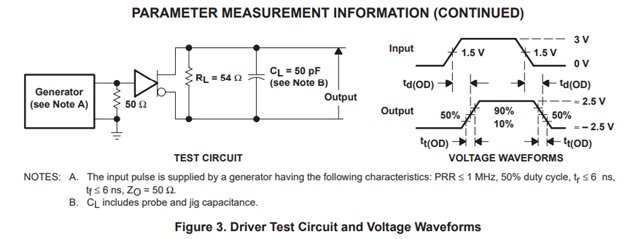

    If none of what I said above is helping to solve your problem, would you be able to setup a test circuit to test your SN75179B driver circuitry to see if it is meeting proper differential output delay time?
    A quick drop in replacement test with another SN75179B device might be helpful here too. We can test to see if the problem occurs on another chip.

  • Hi Tyler,
    This seems to be caused when driver input signal transition time takes several hundreds micro second. I sent the waveform in off-line.
    Please check it.
