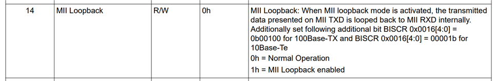

  • Hi Dean,
    Thanks for the information. I suggest we do some debug experiments to isolate if the problem is with the MAC interface or the Copper Interface of the PHY.
    Can you please check the following?
    1. Reverse Loopback on DP83826:
      Reverse loopback loops data coming from copper receive path of DP83826 to copper transmit path and can be enabled by programming 0x0016 = 0x0110
      After enabling reverse loopback, please try to ping from PC and check if the PC is pinging itself. If this works, there is no problem with copper interface.
    2. MII loopback on DP83826:
      Disconnect connection to PC and enable MII loopback (settings available in datasheet)
      With this loopback, the data received on PHY through pins TX_D* is looped back to RX_D*.
      After enabling MII loopback, initiate a pin from STM32 and check if it is able to ping itself. If this works, there is no problem with MAC interface.
    Please let me know if you need more details.
    Gokul.

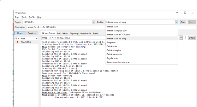

  • Thanks for hanging in with us.
    Question on first loopback: "please try to ping from PC and check if the PC is pinging itself. If this works, there is no problem with copper"
    What am I pinging? if I don't know the address in the first place. (i.e. does not show up on arp -a or by pinging what we though we are setting it to).
    Thx
    Dean
  • Hi Dean,
    Since this is a loopback, the MAC can ping it's own address.
    Else, you can initiate data transfer from the MAC and make sure that the MAC receives the same data back.

  • Very clear. But if I don't know the IP address (or is not recognized by the network of PC) then how is that going to work?
    Does it point to a problem on copper side (or just inside of magnetics).
    Thx.
    DJK

  • Will investigate how to do this. Ran some internal loopbacks and it looked ok. See attached.
    DJK
    // Full End to end Digital loopback (Note packet generator says its on and PHY enabled)
    CR3 before= 0
    CR3 reset stat = 0
    CR3 after= 0
    BISCR_Register before= 100
    BISCR_Register after = 3304
    BISCR2_Register packet length = 424
    [15:8] at 0 secs is of the BICSR1 error count = 0
    BISCR_Register = 3304
    [15:8] at 5 secs is of the BICSR1 error count = 0
    [15:8] at 10 secs is of the BICSR1 error count = 0
    [15:8] at 15 secs is of the BICSR1 error count = 0
    [15:8] at 20 secs is of the BICSR1 error count = 0

    // MII Digital Loopback is requires following configuration:
    //• 0x0000 = 0x2100 // Disable Auto-Neg
    //• 0x0016 = 0x0104 // Digital Loopback
    //• 0x0122 = 0x2000 /
    //• 0x0123 = 0x2000
    //• 0x0130 = 0x47FF
    //• 0x001F = 0x4000 // Soft Rese
    BISCR_Register after = 100
    BISCR2_Register packet length = 5EE
    CR3 before= 0
    CR3 reset stat = 0
    CR3 after= 0

  • Ok. Reverse Loopback on. See attached. Not sure what to make of it. Long test (not complete) but it finds some active ports. But UDP traffic seems to be getting dropped all over the place. Will update with more later.
    Using NPing to generate traffic. 8/17/22 9am.
    From device: BISCR_Register = 3310
    Starting Nmap 7.92 ( https://nmap.org ) at 2022-08-17 07:54 Eastern Daylight Time
    NSE: Loaded 155 scripts for scanning.
    NSE: Script Pre-scanning.
    Initiating NSE at 07:54

  • I ran multiple scans. This one is "Intense with TCP ports". Bottom line is raw to and back:
    Nmap done: 1 IP address (1 host up) scanned in 511.95 seconds
    Raw packets sent: 130889 (5.764MB) | Rcvd: 694 (62.108KB)
    Shouldn't I get back 5.764MB?
  • One last revision. I failed to turn my wireless off and cable might have been wrong. Direct from PC cross cable....no data returned.
    Host discovery disabled (-Pn). All addresses will be marked 'up' and scan times may be slower.
    Starting Nmap 7.92 ( https://nmap.org ) at 2022-08-17 11:12 Eastern Daylight Time
    Initiating NSE at 11:12
    Completed NSE at 11:12, 0.00s elapsed
    Initiating ARP Ping Scan at 11:12
    Scanning 192.168.0.5 [1 port]
    Completed ARP Ping Scan at 11:12, 1.51s elapsed (1 total hosts)
    Nmap scan report for 192.168.0.5 [host down]
    NSE: Script Post-scanning.
    Read data files from: C:\Program Files (x86)\Nmap
    Nmap done: 1 IP address (0 hosts up) scanned in 2.48 seconds
    Raw packets sent: 2 (56B) | Rcvd: 0 (0B)
  • Hi Dean,
    I am not aware of the specifics this tool does. I need your help to understand what the tool is doing and let me some information from a PHY level.
    Gokul.
  • Reverse Loopback is enabled. We would expect to see exactly the traffic sent (regardless of protocol) out our one enabled RJ45 jack to the device and then looped back. I attached a pic of various things you can send. You data sheet has diagrams of what PHY does in reverse loopback.
  • Hi Dean,
    MAC level tools and protocols are out of scope of my knowledge base. I am not sure why the data is not being transmitted or received. Is it possible to send a continuous burst of packets and check if they are received back?
    In parallel, can we also try this out from the STM side by getting in touch with STM vendor to check if the loopbacks work. MAC usually supports different loopback tests just like Ethernet PHY.
    When testing from STM side, you can try out MII loopback, PCS loopback and Analog loopback and check if all of them work properly.
    Gokul.
