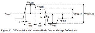

    You may refer to figure 12 for the voltage output parameter definitions.

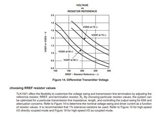

    For the default SerDes configuration the output values will be at around the typical (TYP) value. The user can tune the output by adjusting the RREF value. Refer to datasheet section "choosing RREF resistor values (page 21)" for details.

    I think that pre-emphasis and deepasis are two methods of compensating characteristics on the transmission side according to the attenuation characteristics of the transmission line, but is this correct? If so, is there a way to select Vod(p) and Vod(d)
    That is correct. De-emphasis and pre-emphasis allow the user to pre-distort the waveform in order to provide equalization. The level of VODP and VODD applies is determined by the value of RREF chosen. See datasheet snapshots below.

    For example, when outputting "1100" data from "DOUTTXP" and "DOUTTXN", is it possible to output only the Preemphasis VOD (or Deemphais VOD) waveform?
    Or does the TLK1501 decide whether to output the Vod(p) waveform or the Vod(d) waveform according to the bit pattern of the transmission data?
    When outputting the data of "1100", will it be the image of "Figure 12" in the data sheet?

  • The Pre-emphasis and De-emphasis applied to the signal combined provide complete post-cursor equalization. You need VODP and VODD to be incremented in tandem. By emphasizing the first bit in a given sequence you are effectively applying post cursor equalization.
