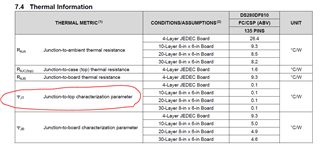

Part Number: DS280DF810
Hi Team,
Need ABW package Thermal information, thanks!
Hi Kevin,
I'm looking into this and can provide more details tomorrow.
Drew
Hi Kevin,
The following thermal information is for ABW 4-layer JEDEC board.
Theta JA-High K (standard datasheet value): 22.1 C/W
Theta JC, top (standard datasheet value): 1.4 C/W
Theta JB (standard datasheet value): 7.0 C/W
Psi JT (standard datasheet value): 0.3 C/W
Psi JB (standard datasheet value): 7.0 C/W
Drew
