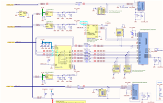

We are debugging the USB C connector. We are able to run on SuperSpeed (3.X) for one orientation; but for the other orientation it only gets HighSpeed (2.0)
I have been following the discussions here on E2E, but so far I can't find what can be the issue.
What I have seen so far, is that the DIR signal always have the same value no matter the way I plug something on the USB connector. CC1/CC2 pins do change value.
I found some errors on our design compared to the guidelines. But even patching it doesn't seem to solve it.
Any idea what could be the issue? Thanks a lot.
The intended mode is DFP.
Also tried with VBUS_DET floating as in datasheet suggests for this mode, but not an improvement either.
When I patched the VDD to +5V_SW, now it doesn't detect at all one of the orientations. What can it be?
If I pull down the SEL pin on U16, then the polarity of the connector is reversed.

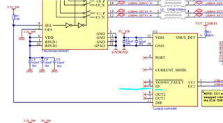

  • Hi Cora,
    I see the ID pin is left NC in your schematic. This pin is typically used to control the Type-C VBUS switch.
    How do you control the Type-C VBUS?
    We've had cases where not controlling the VBUS leads to issues with detecting one orientation.
    Shane
  • Hi Shane!
    I saw it! I took it from the reference design guidelines from Toradex. (Here is the link to the documentation:
    https://docs.toradex.com/101123-apalis-arm-carrier-board-design-guide.pdf  - go to Figure 36 / page 40 )
    There they have ID pin floating, and the VBUS switch is controlled by im8x pin
    I will patch it and try it, although now that ID pin is floating, when measuring with the oscilloscope I can't see any change of voltage there going on. But will try!

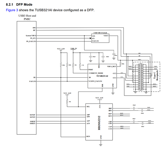

  • Hi Cora,
    is it needed then for sure the VBUS_DET connected even for DFP mode?
    It is ok to leave VBUS_DET unconnected in a DFP only application. It is also ok to leave it connected to the VBUS as you have done.
    I took a look at that reference schematic and see the PORT pin is left NC, which would be Dual role port (DRP) mode on the 321.
    If you want DFP only mode, pull this pin up to VDD.
    The ID pin is an open drain output. You would need to pull it up to 3.3V or no voltage will appear on the line. Here is the typical application schematic in the 321 datasheet to demonstrate how ID is implemented.
    If your VBUS switch has a low-enable pin, you can route ID directly to the enable pin on the switch. ID will go low when the 321 expects to provide power on VBUS.
    Let me know if you have any questions.
    Shane

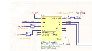

  • Hi!
    I have updated the patches as suggested:
    PORT pin to 5V with 4.7k
    ID pin to 3.3V with 200k
    VBUS_DET pin left floating
    I still get the same results: In one orientation of the flash memory USBC I get SuperSpeed, in the other orientation I get HighSpeed only
    I can't see the ID pin go low when plugging in a flash memory in either both positions.
    DIR pin stays always the same value in either both positions.
    What else could it be? Where could I measure?

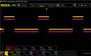

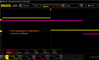

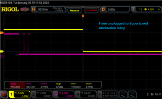

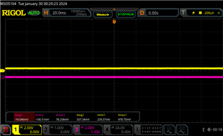

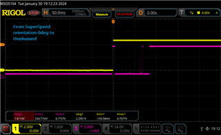

    With this set up, I can see on CC1/CC2 voltages (CC1 - yellow // CC2 - purple):
    •  2A. When unplugged flash memory: (Is the oscillation normal?)
    • 2B. SuperSpeed detected (orientation 0deg):
    • 2C. High Speed detected (goes through 2.0 lines) (orientation 180deg):
    For all cases, SEL / DIR pin is 0V - no change.
    Also, I have another board where I patched those pins and swapped them. And there, the behavior is the same, but the orientation of the flash memories give me the SuperSpeed and Highspeed the opposite as in the non-swapped board.
    (Saying this to confirm that the lines are good routed and functioning)

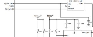

  • Hi Cora,
    VBUS is connected to 5V VDD. Shouldn't it?
    VDD and VBUS should not be connected together for a DFP. You want VDD to first power the TUSB321, then the 321 should control when VBUS is applied. You can see how this is would look from the typical application in the datasheet:
    Now I can see the voltages on CC1/CC2 changing (As the images)
    That oscillating makes sense for a DRP, however if you are in DFP mode CC1 and CC2 should be held at 5V constantly. Do you see this behavior on the 321 after pulling PORT high or is PORT still NC?
    Could you show the CC lines at the point when the device is attached? (The transition from unattached --> attached). It seems your pictures are after the device is already attached, when both CC lines are at low voltages.
    Shane
  • Hi Shane!
    Thanks for pointing out the DRP mode and the PORT configuration Thumbsup
    The previous images where with PORT floating.
    Following images are with PORT pulled up. (no more oscillating)

  • Hi Cora,
    Are you able to share the schematic as it is now? I know there have been some changes since the original one you shared and want to be sure I have the right idea.
    Is the 3.3V_SW power rail that connects to DIR going high before the VDD pin on the 321?
    DIR can potentially back-drive the device if it goes high before the 321 is powered on. If back-driving occurs the 321 could have issues initializing.
    Shane
  • Hi Shane,
    It works now, thanks for all the help!
    Apparently, the two boards I had, the 321 was damaged; once replaced for a new one, it worked as it should! (Voltages on CC1/CC2 where 5V when unplugged and went low when plugged flash memory)
    Also, on my design VDD (pin12) was connected to VCC_USBH4 (Connector) instead to the 5V_SW (System) <- This had a major impact, once patched on a new-healthy 321, it worked!
    This is my working set up now :) It detects SuperSpeed in both orientations/positions of the USBC flash memory.
    Thanks a lot! :D
