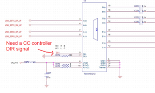

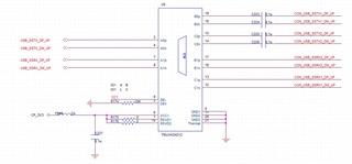

Hi TIer
Could you help me review the schematic and layout?
The customer thinks their traces are crossing and not going well.
Thank you very much,

Hi Yuxi,
I see you are using this MUX in a type-C application. Can you share the layout as a .brd cadence file? I can't see the MUX connections from your image alone.
I have another comment on the MUX SEL signal. It looks like you've routed CC1 directly from the type-C connector to this pin. This would be incorrect, as you need a CC controller to output a DIR signal for the MUX SEL pin.
Do you have a CC controller in your design?
Otherwise, the schematic connections look ok.
