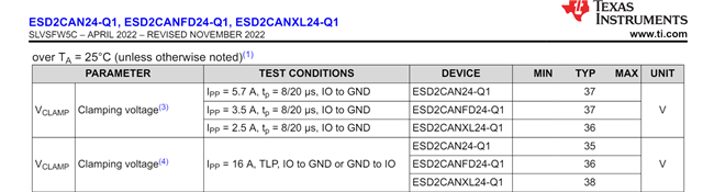

I am trying to diagnose why our CAN transceivers keep breaking somewhat arbitrarily when the modules are connected/disconnected from the live system.
All our modules utilise the TCAN334DR CAN transceiver.
All modules have a ESD2CAN24DBZRQ1 located very close to the PCB CAN connectors.
According to the datasheet the clamping voltage is around 35-37V depending on Ipp:
It looks like the TCAN33x has an absolute maximum rating of +-14V on the bus lines:
Safe to say, I think I haven't picked the best CAN TVS for this transceiver, or am I missing something?
Is there a recommended TVS to use for this transceiver?
