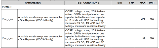

    Is "during data transfer" similar to the condition described below?
    Jack
  • Hi Jack,
    The worst-case power consumption is measured over voltage and temperature with a configuration and signal pattern that maximizes power consumption. Power consumed during normal operation is less than this.
    Nicholaus
