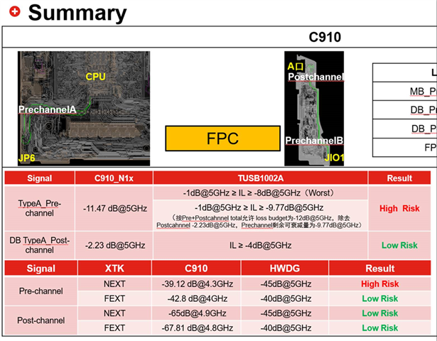

Pre channel loss 11.47dB,Post channel 2.23dB; customer want to check if TUSB1002A can support it. would you please help me check it?
Customer want to check the EQ setting, do you have any suggestion?

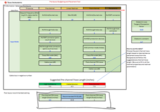

I recommend using the trace length budgeting tool created by David. The TUSB1002A is a linear redriver so you will need to use the TX budget and RX budget tabs for the liner redriver.
Please fill out the information that the spreadsheet requires using the layout file you have access to.
The tool is here:
4478.RX & TX trace length budgeting - TI information - selective disclosure - revI.xlsx
password: ti
This tool will provided a recommend EQ value based on the inputs provided.
