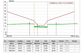

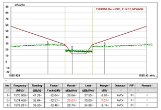

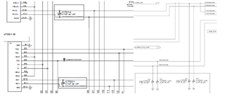

Currently, we met the issue on the GPS band. (1.56G~1.58GHz) Below is our work around.
Before
After
But I am not sure if it will affect the SI if we place the HF cap on the USB3 line. Do you have any other suggestions?
