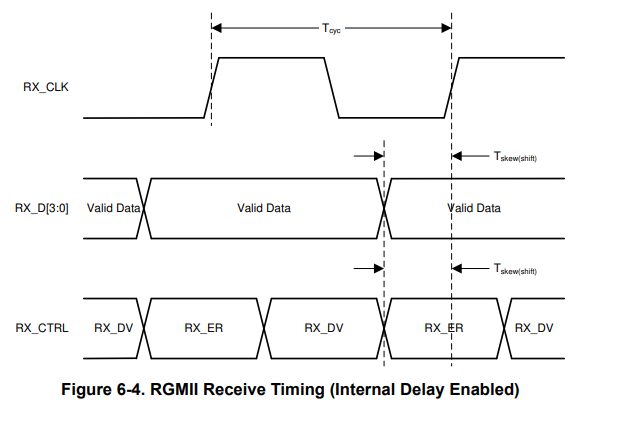

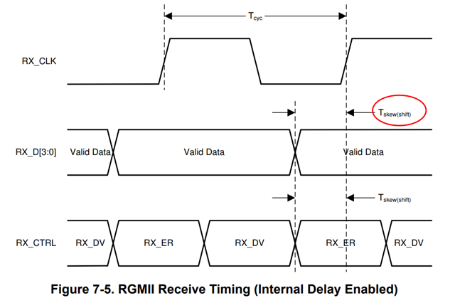

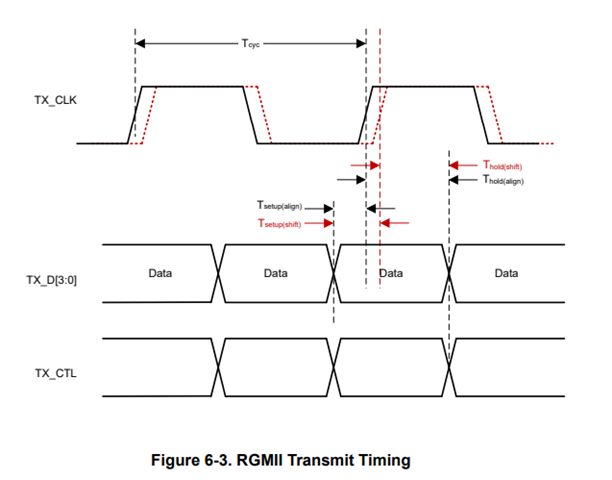

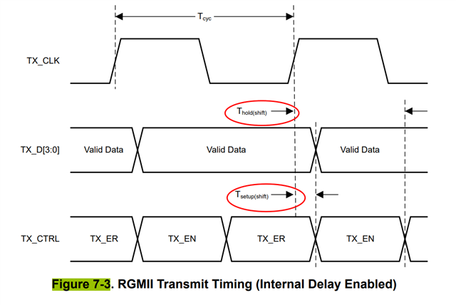

Would you help share the RGMII spec marked by red? Customer didn't find them in the datasheet.
T_hold(shfit), T_setup(shfit), T_skew(shift)

Hi Ted,
The figures in the DP83TC812 datasheet are more up to date.
A minimum of 1ns setup and 1ns hold time must be maintained at the input of the receiver. In RGMII RX shift mode, the PHY shifts RX_CLK ahead of RX_Data signals by roughly 3ns.
See https://www.ti.com/lit/ug/snla431/snla431.pdf
Nick
Hi Nick
Don't find the specs of T_hold(shfit), T_setup(shfit) in TC812 datasheet.
Pls share them.
Hi Ted,
The receiving Tskew values will not be in our datasheet since it is controlled by the MAC. Thold(shift) and Tsetup(shift) should follow the requirement of a minimum of 1 ns, with the maximum being around 3-4 ns.
