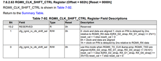

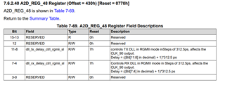

Here is a summary of available information about RGMII Shift and Align mode for our DP83TC81x devices:
  • A minimum of 1ns setup and 1ns hold time must be maintained at the input of the receiver.
  • The delay can be added by PCB traces, by the PHY or by the MAC
  • Either way, it is based on the RGMII input timing specifications and must be maintained.
  • RGMII shift mode means there is an added delay. RGMII align mode means there is no added delay.
  • TX Delay
  • TX + RX delay
  • CLK Shift registers
  • The maximum programmable delay by our PHYs is 5 ns and the default is 2.5 ns.
