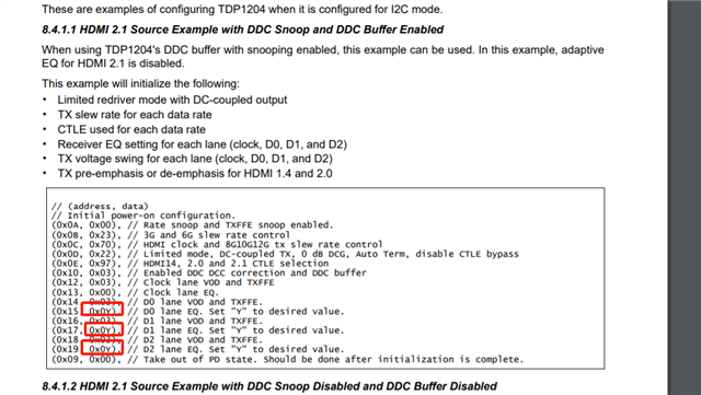

The customer requires the HDMI driver configuration file for TDP1204. Please help provide it. Thanks!

TDP1204 can be configured in either pin strap or I2C mode, but there is no driver needed for TDP1204.

What parameters need to be configured through IIC, and are there any relevant reference routines?
Is it sufficient to simply configure through the PIN STRAP pin?
Thanks!
You can configure TDP1204 just through the pin strap pin. Please see this app note https://www.ti.com/lit/an/slla591/slla591.pdf for more detail.

As indicated by the red mark in the following figure, what is the typical EQ value set? Thanks!
Do you know the channel loss between the SoC and the TDP1204? The EQ value needs to be set as close as possible to the channel loss between the SoC and the TDP1204 to help compensating the channel loss.
